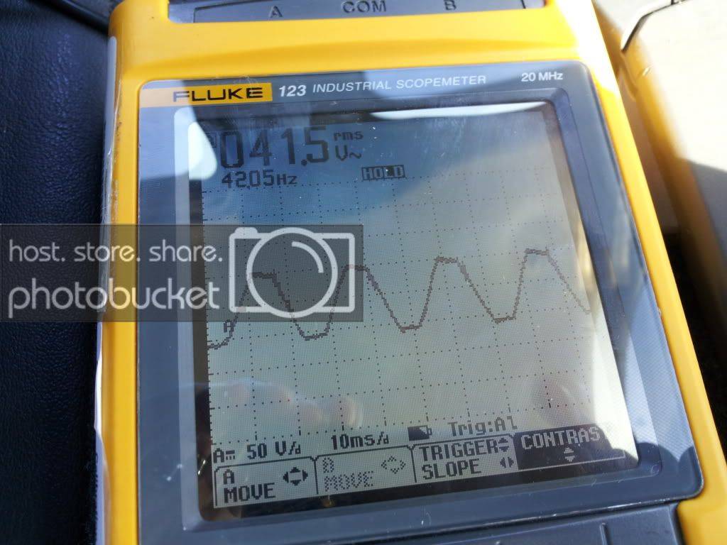

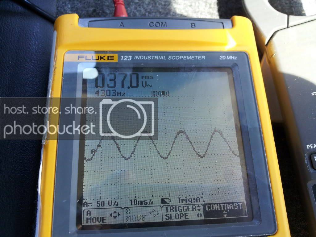

The waveform dose not suddenly go square wave, Even when well into clipping you can still get AC content.
This image is when i clamping my MB ref1.800 note the RMS reading on the top of the meter, its AC coupled. Note the 5volt difference.
A DMM will only show you part of the picture. Im not a fan of DMM tuning ,becasue if you don't fully grasp whats going on you can do more harm than good.
