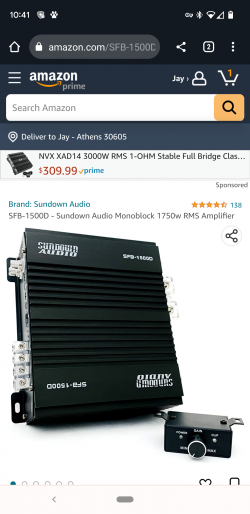

I didn’t see anything about blue and yellow lights in the bass remote section of the manual. If you head over to your amp and look just above the gain control is the “clip” light flashing as well? I bet it is. Turn your gain down.
