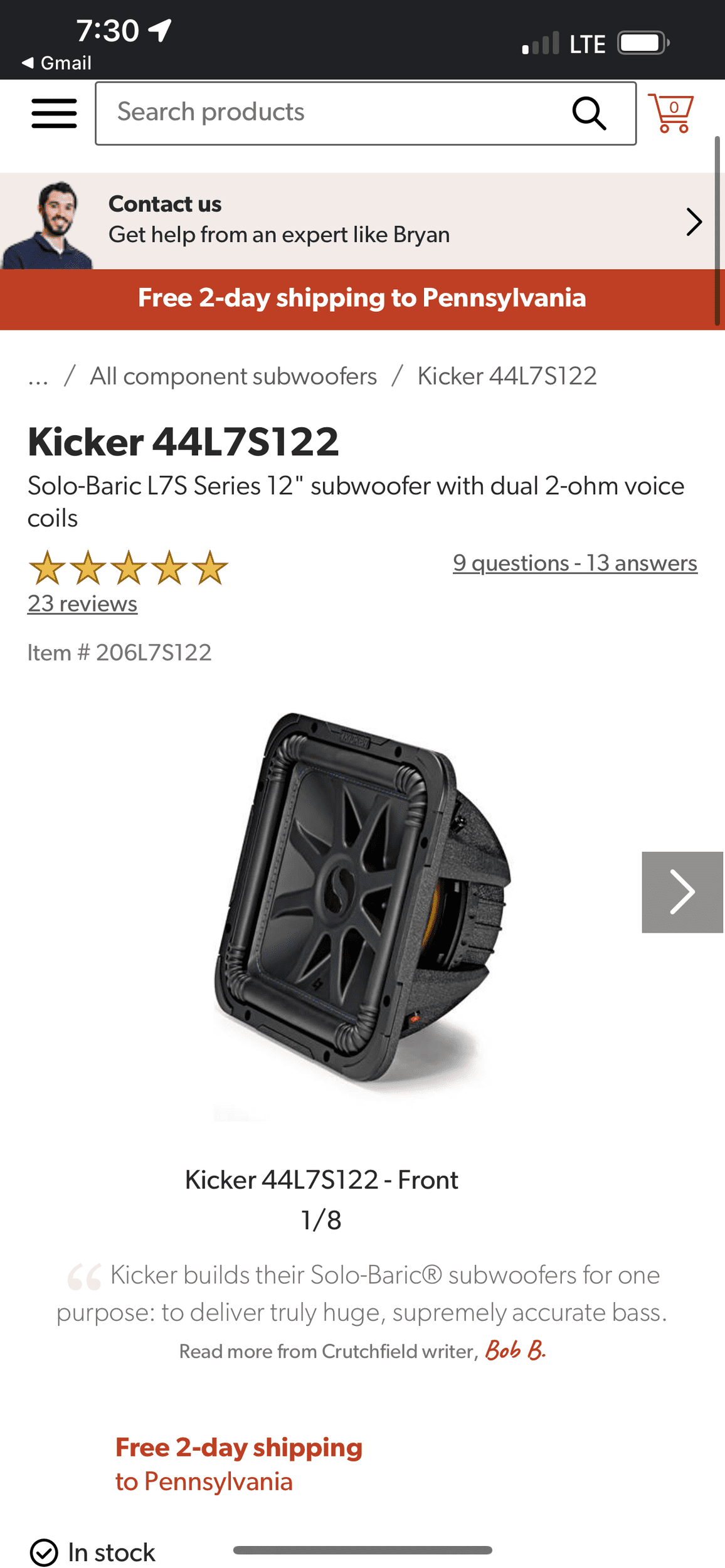

So I’m putting 2 kicker L7S 12” subs in my car they are dual 2ohm voice coils. I want to wire them to be bridged at the amp with 2 ohm impedance does anyone know what amp that is not going to break the bank that would work best to be ran at 1500watts 2ohm bridged

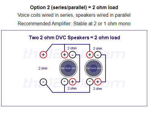

With Dual 2 ohm VC woofers, you will need to wire them as follows for a 2 ohm load to the amplifier:
Those Kickers are rated for 750 watts RMS, each or 1500 for the two.
