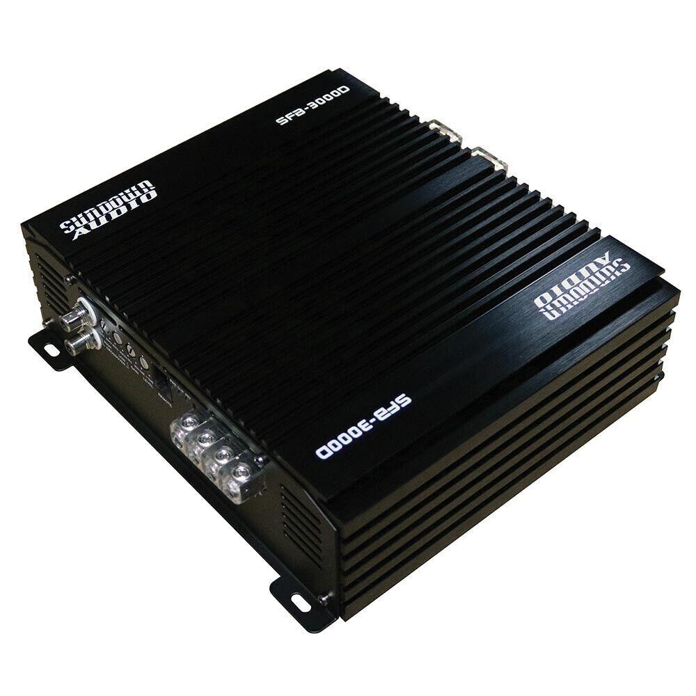

$260

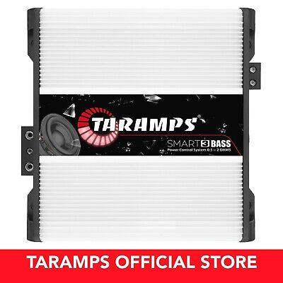

$599 (2500 watts at 2 ohms)

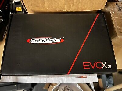

$500 (offer) 2300 watts at 2 ohms

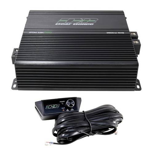

$550 3000 watts at 2 ohms

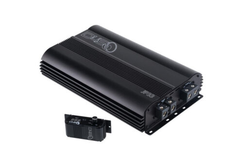

$350 2000 watts at 2 ohm
