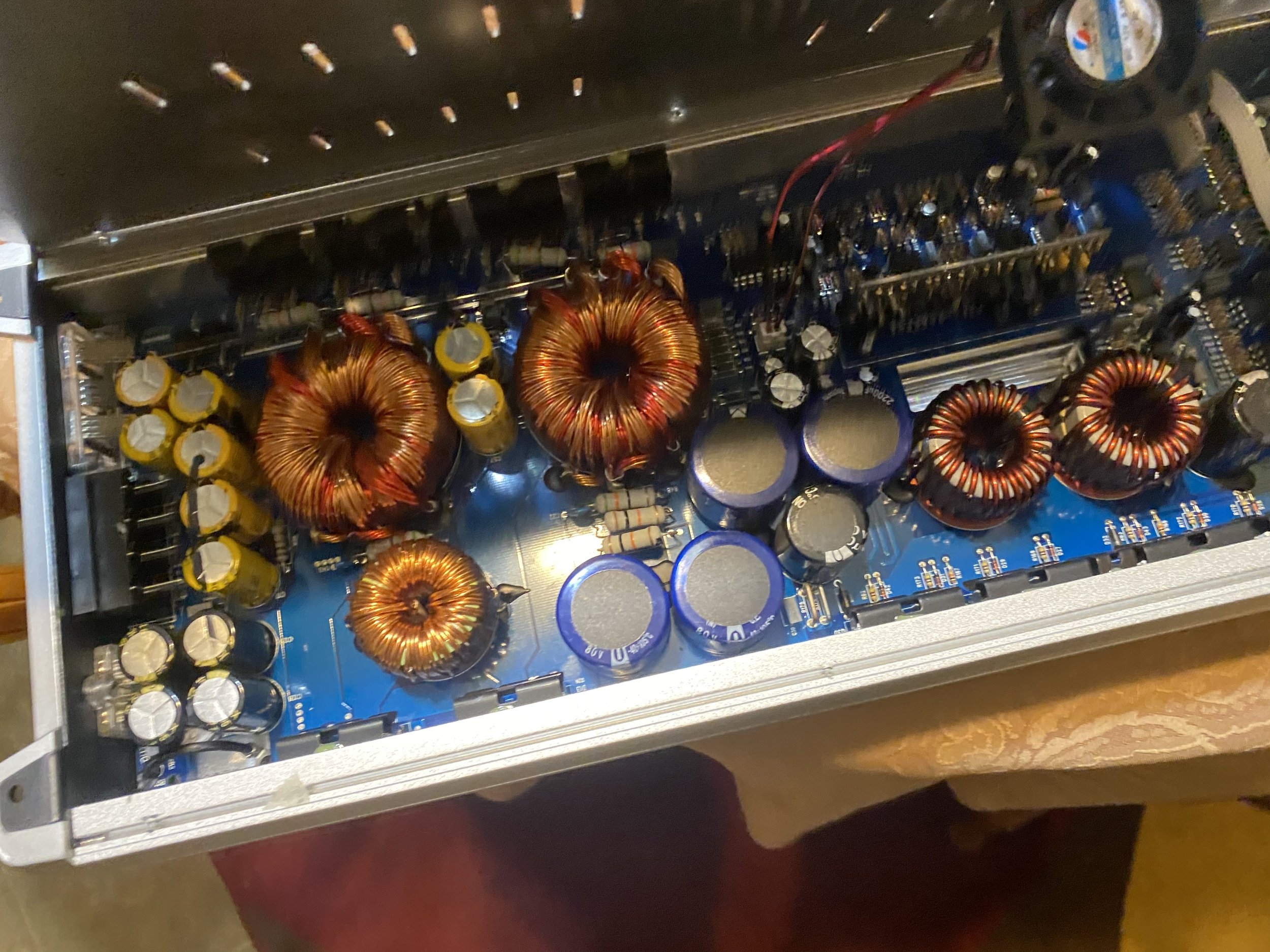

Does anyone know anything about this board style.what other amps use this board.its logic soundlab axp4000 fused 4x40 amps.really clean sounding amp.just conversation starter,ive had it couple months and im working on getting my custom zvx 18 in my car.
Similar to the Power Acoustik A1800db / A2400db / a3000db / OV1-5500D amps, Planet Audio BB2400, Soundstream PCA2000d, and several others that use the same basic generic design for different power levels. The output driver section in this design run hot and prone to failure. If the fan starts to fail that blows on the driver card, it’s pretty much a death sentence for the amp. If the fan ever sounds funny, stop using the amp until you replace said fan, fans do go bad and need oiled or replaced. I'd agree that 1500rms is in the ballpark for that one.
