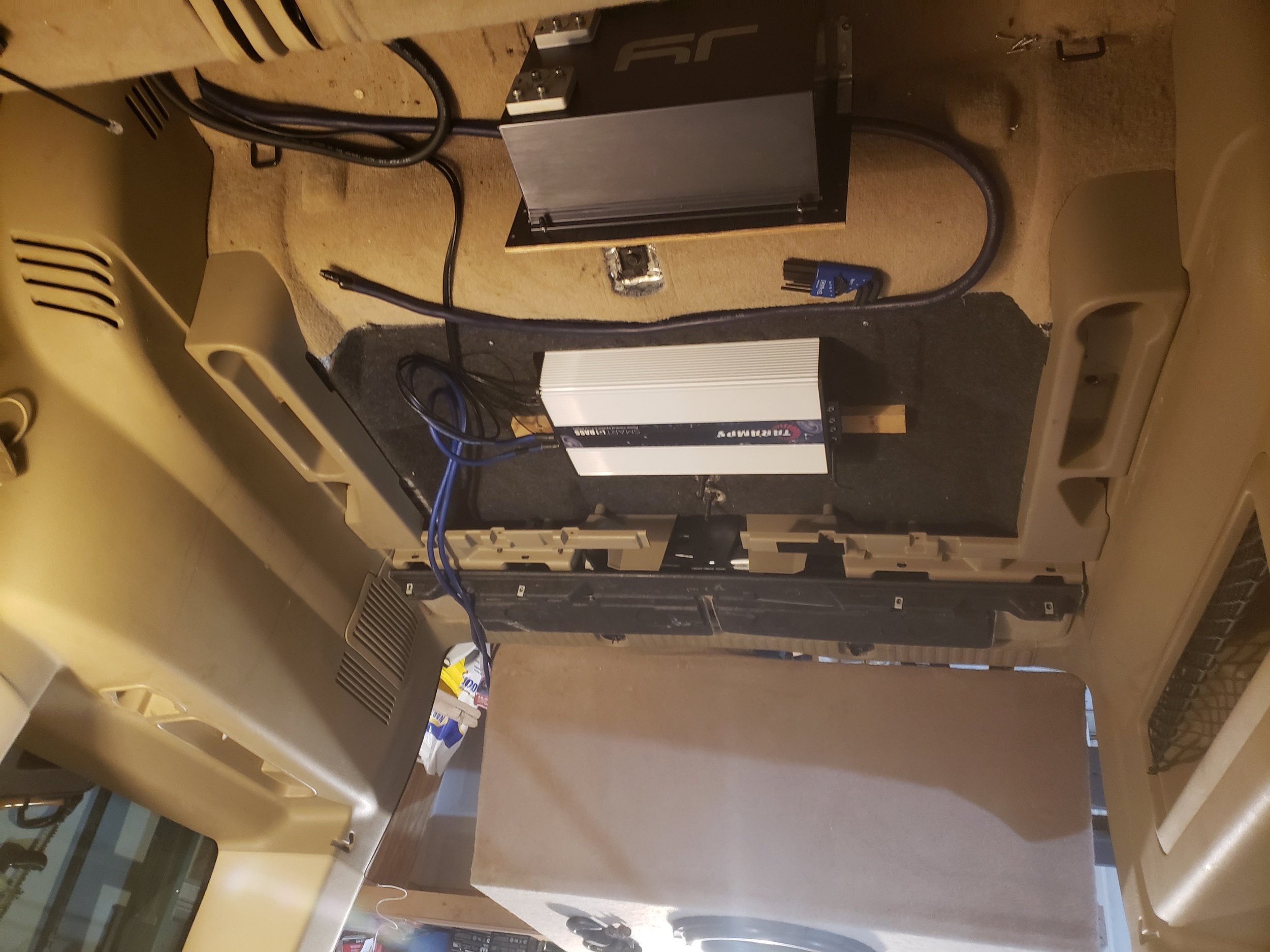

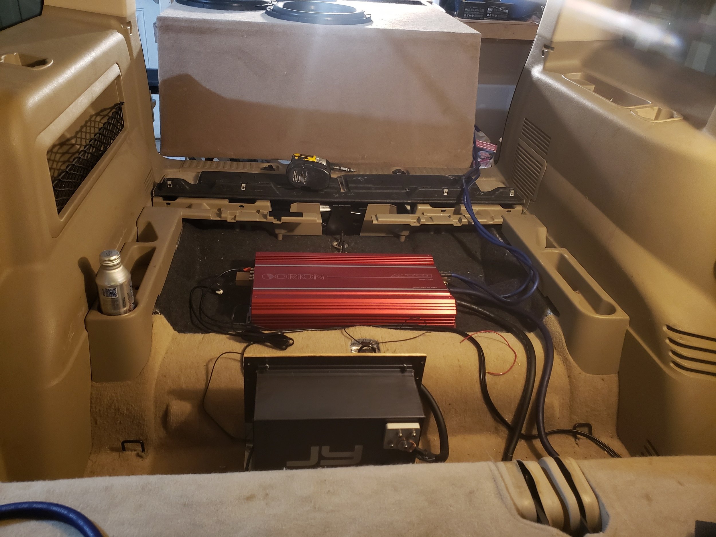

I beat the snot out of my Smart 3. Finally sold it and bought a smart 5 that I'll be installing soon. I'm not for or against full or half bridge amps. But from where I sit, it's hard to beat the price to performance of Taramps full bridge amps.
Matt
My smart 5 is fantastic but I really do like something with better Xovers. I’d had no issue with going with a half bridge but space is limited. I could probably lay things out different and do it. I’m sure with time since I like to try new things it’s exactly what I’ll eventually do 😂.
