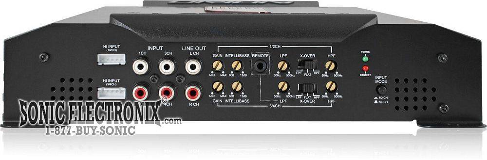

here is the pic..:
you might wanna try setting it as 2 channel as well on that button on the right
but you need all 4 inputs driven... not always but usually...
the Quart DSC amps do not because they have what is called a dupe setting the Orion does not appear to have 1..
well thats my problem, i just figured if i flipped that switch to 2 channel, i would only need to put the RCA's into channel 1 and 2, gonna try that tomorrow, as I have some spare monster Y's from my old system.......thanks so much, my car audio newbness shown thru and I never woulda figured that out on my own, will let you know how it goes tomorrow, thanks a ton
