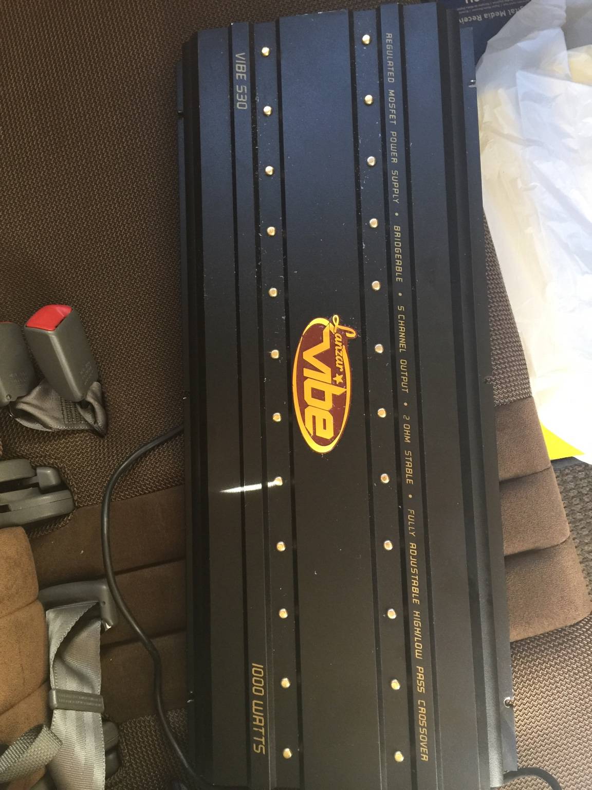

I have a 1000w amp driving two kenwood 12 subs.
The drivers are running on channel 5, with the head unit running into 5 and 6. This setup worked fine for two weeks, but randomly died. Every time I try to turn it on, the pwr light fades off after about a second, and the prt light stays on.
Thought it was a loose connection issue; I got a crimping tool and re-crimped the +/- wire blades, and re-sanded the chassis ground surface, installing a proper ground bolt thru the chassis while I was down there. Didn't fix it.
What do I do next?
Well, the amp's integrated fuses are not blown, the amp's inline power fuse is intact, and the h/u is still fully operational. The amp is still getting power, so I don't believe there's any blown fuses- the darn thing just won't stay turned on!
