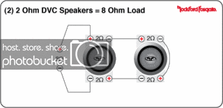

wired the subs in 4 ohm
thats how i wired the subs
