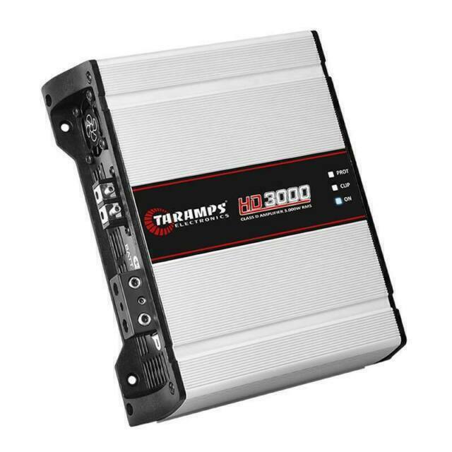

Big ups to you on letting your kid listen to his loud ass rap music with all that bass. However, two of those subs will take a good amount of electrical and those defenders only have 100 amp factory alternators. I would grab two of these instead of you’re going to stay on that brand
This amp would be plenty for relatively factory electrical. It would be enough for one elite as well. Do the big 3 and put an agm under the hood
