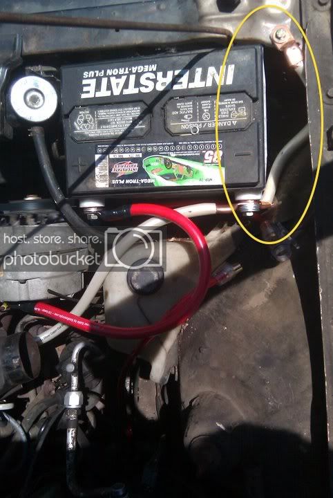

not what i was talking about... what size is it at the front near the battery up front? where the frame goes to the battery?
This is my brother and Is chevette project the circled ire is the one i am referring to, yours may not be this obvious but....
Mine is like 8ga! i was going to replace it soon, do you think thats why it gets all hot?
It could be, its absolutely pointless to have 1/0 from amp to frame then 8ga to batt....... just like having 8ga all the way... Im not sure whether it matters in your case as I was and still remain to lazy to look up the specs on your amp. People are probably going to shit on your face for that though //content.invisioncic.com/y282845/emoticons/fyi.gif.9f1f679348da7204ce960cfc74bca8e0.gif
