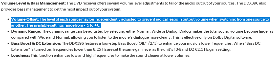

Any balancing should be done inside of the head unit or on the phone. There's no reason to adjust the amp gain settings when switching sources on the head unit. A lot of aftermarket units, at least on pioneer that I know of but it's probably common, have settings that adjust source volumes relative to each other to avoid blasting loud noise when you switch to the radio, etc.
The included image shows what feature you're looking for. It was snipped from this page: https://www.crutchfield.com/p_113DDX396/Kenwood-Excelon-DDX396.html assuming your head unit is quite similar to that one.
