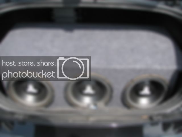

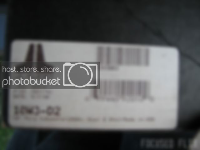

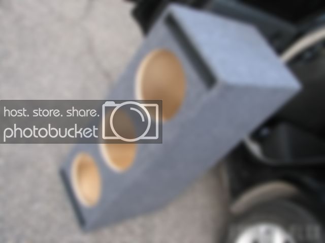

I have 3-10w3's in a ported enclosure that I recently bought. The subs are older, born date is in 2000 (as you can see in the pics). The subs are 300w RMS each, dual 2ohm. I have the subs wired for a 1.34 ohm load. My budget is $200 for an amp. If that's unrealistic, please let me know. It's in a 07 Dodge Charger if that matters. I already have an amp ran with 4 ga. power and ground and would like something that I could use with that wiring. The amp I have does 600w @ 1ohm and I'm sure I'm underpowering the subs (that amp was for 1 jl12w3v3)Rap and r&b are the main genres of music being played.
