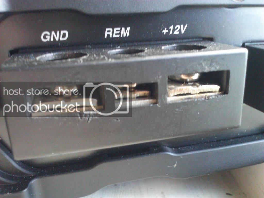

About 6 months ago I bought a Kicker CX 300.1, hooked it up, loved it. now about 2 months ago i was moving my setup around a little so I had unhooked the cable from the battery to be safe. I moved things to where I wanted, hooked it back up, and the ends of the power and ground wires lit on fire for a second or two before the 50A fuse under the hood (on the power cord) blew. since then, every time I try and hook it up, the 50A fuse blows. There's no external fuse on the amp so I'm not exactly sure about how to repair it. The whole setup works just fine still with the Kenwood.

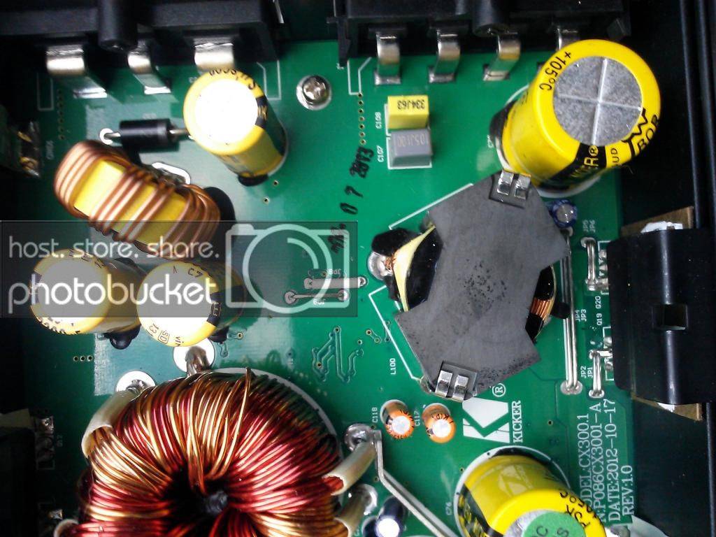

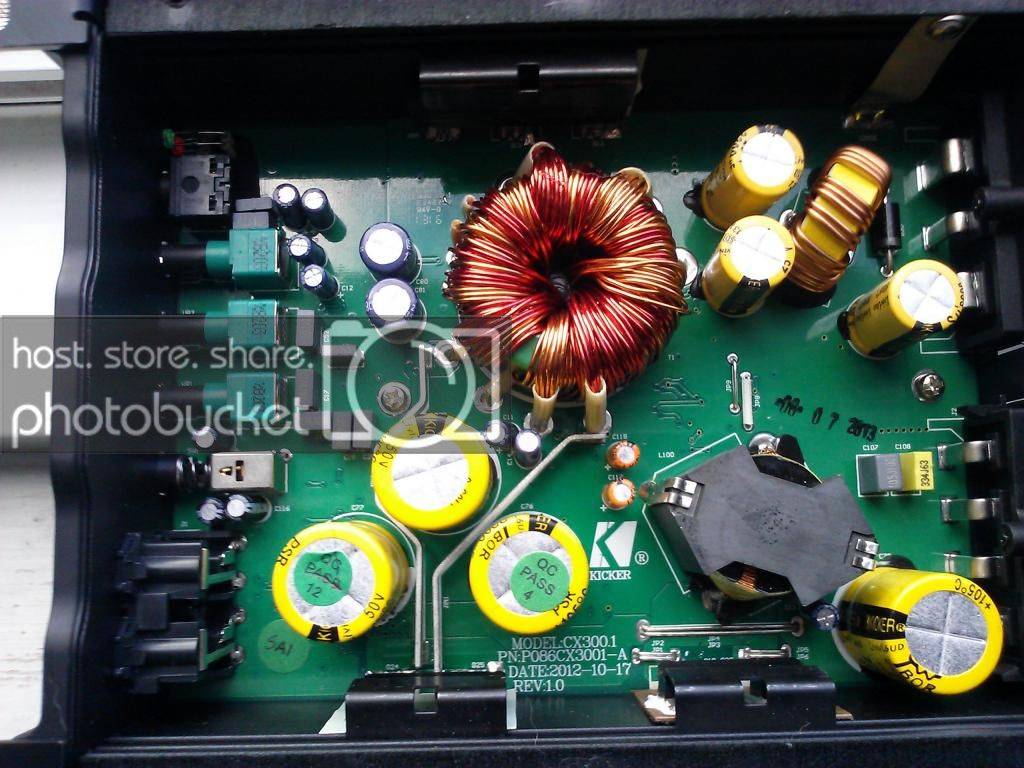

Right, I've already done that. There's nothing cracked or burnt inside, the only thing that got burnt was the connections on the exterior of the amp for the power and the ground.

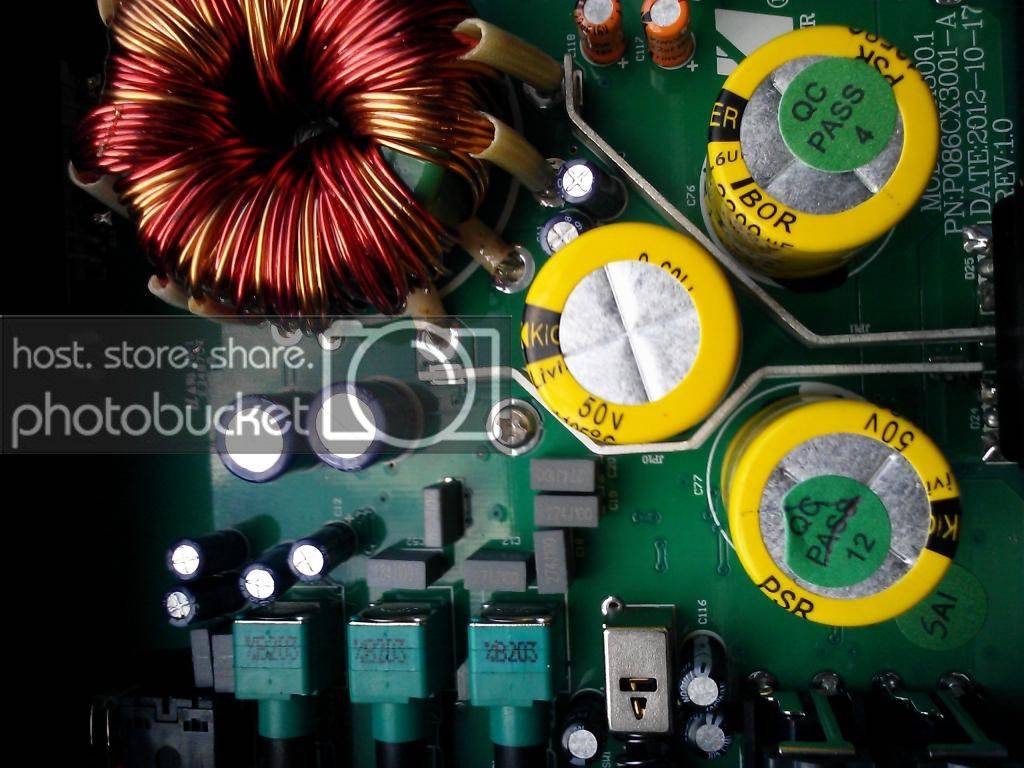

Maybe these will help. My specifications are the top one obviously. This is inside of it, nothing burnt or cracked. It doesn't smell overly electrical either.

From your description of the wires catching fire and the fact that the circuit board isn't burnt inside, I would suspect a dead short at the power terminals on the amp. Like metal touching metal, or the 12V terminal touching the amp chassis. Take a look for signs of sparks in the area of the terminals.
