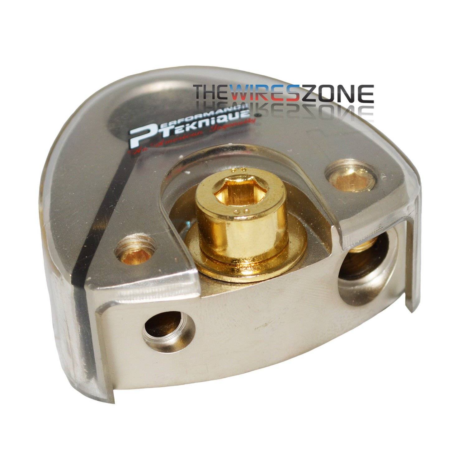

After spending the majority of my morning browsing every type of terminal, I have made my choice. There were options I liked better but they were either too expensive for what they were or didn't come with a cover, which would drive me absolutely nuts.
I went with two of these (Both pos, neg didn't have a center bolt) and will use my existing pos>neg spacer.
Now i can properly crimp/solder some copper ring terminals onto the alternator and amplifier wire and attach them @ the center post. I'll then use my factory 4awg and 8awg in the set screw inputs. Same for the neg side, 4/8awg into the set screws and solder on ring terminals for the chassis and engine ground @ the center post.
And all for $6/pc. Hell of a lot cheaper than some of the shitt!er options I looked at.

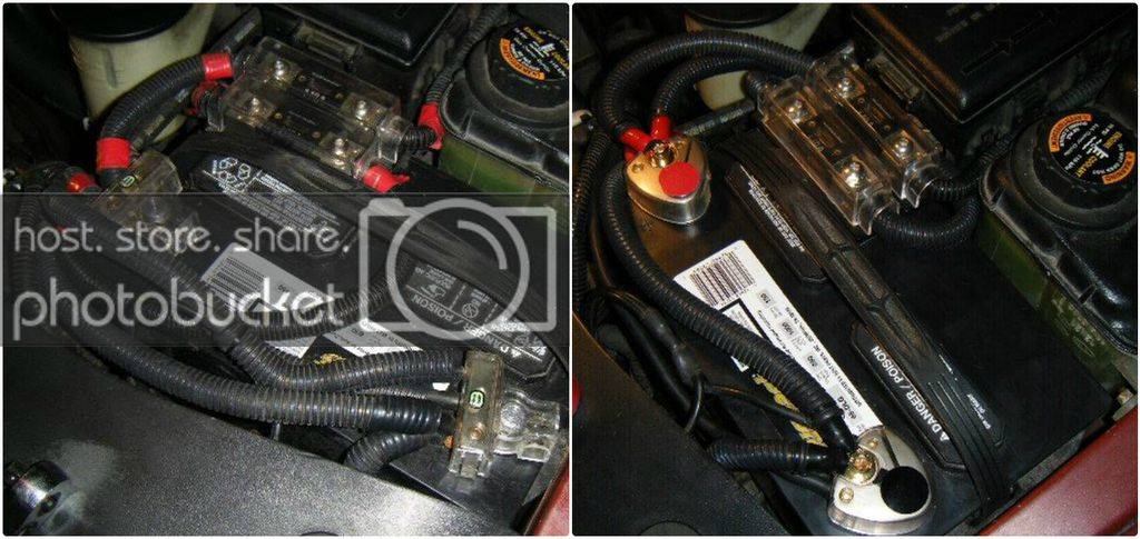

And she's done-

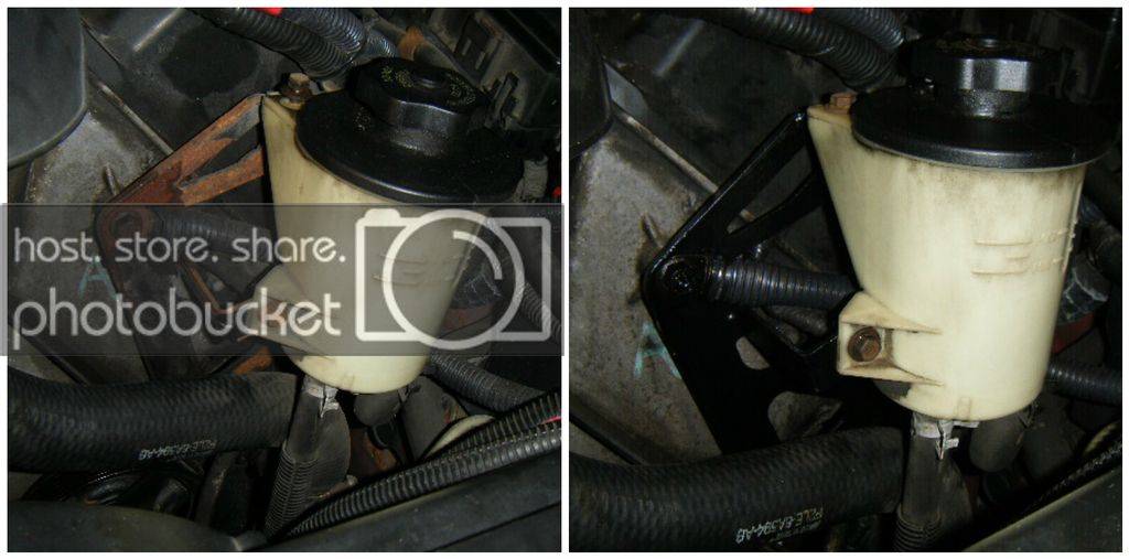

Couple before and afters. Ended up just going with the generic gold plated terminals that everybody uses.
