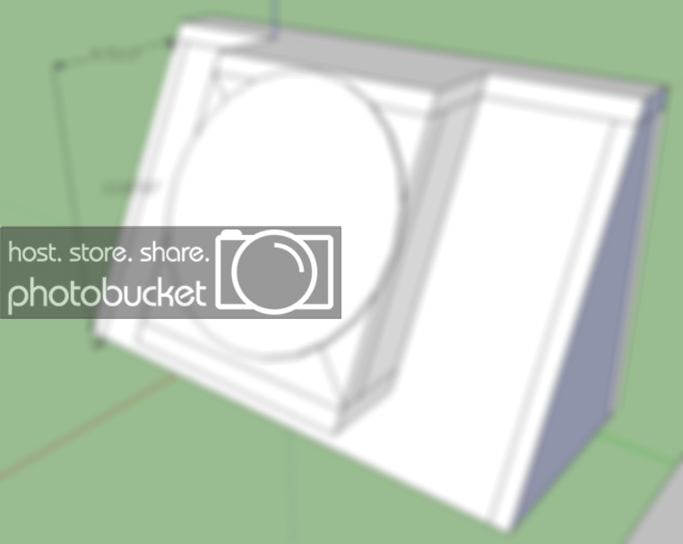

I recently designed an enclosure that lets me mount my 10" type R between the rear seats. I designed it on sketchup.
I was foolish and didn't take the time to model the sub to make sure everything fit correctly. now ran into some issues.
The space between the seats is 10", so the face that the sub mounts to is 10" across. once the sides of the extension are in place i loose 1.5", so my mounting diameter is down to 8.5" and i need 9.1". Additionally i fear that the structure of the extension won't be strong enough to support the weight of the sub.
So my solution so far has been to replace the sides and bottom of the extension with 1/8" aluminum. aluminum panels will be fastened to the mdf face and top. flush with the face and extend into the main volume structure and 90 degree on the backside of the main (structure) face. I figure the vertical aluminum panels would be plenty strong to support the sub woofer, and at a fraction of the thickness. and the mounting method (90 degree) will distribute the load across a large area.
I plan to throw some deadening on the inside of the panels to reduce vibrations, additionally the seats pressing against them on the outside to further reduce vibration.
has anyone used small aluminum (or any metal) panels in a box? im wondering if it will sound strange. I figured the hard surface of the aluminum isnt any different than that of a FG of plexi enclosure. also i am hoping the deadening and small panels will prevent any weird resonance.
Also the extension is pretty tight around the sub, will this be an issue?
I already own the 10s. i bought them years back and hadnt used them once. additionally i dont think you would get more than one in there. the pass through isnt high enough for a stacked setup.
why wouldn't you glue MDF pieces to each side to make it 10" wide? Kinda lost on why you want to do alum...
the distance between the 2 vertical MDF pieces is 8.5". and i need a mounting hole of 9.1", so the aluminum is a lot less thick, and stronger. so it will give me the space i need to mount it and the strength to hole the sub.

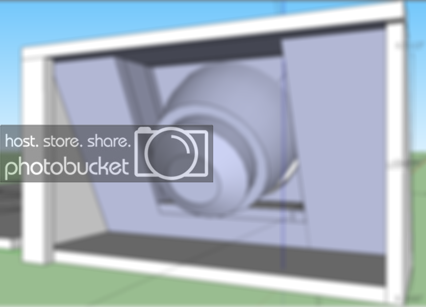

Just looking at your drawing, with the sub mounted that high in a wedge box, it appears you may also have a problem with the magnet hitting the rear of the box.

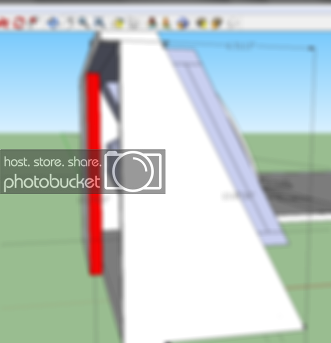

it shouldn't hit, though its close i drew the sub in sketchup as well. the circle on the face, is actually the face of the sub. if i were to rotate the drawing you could see the basket and magnet structure.
the red is the edge of the back, so you can see how close it is to the back panel.
