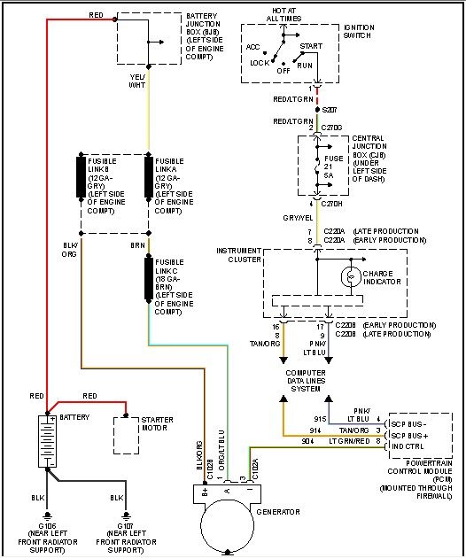

ere is a diagram of the charging system in this vehicle, as you can see, it is pretty straight forward, with the ALT and the PCM as the major players. 99% of the time the fault is in the alternator, even getting a replacement doesnt mean that is is not defective. I would strongly sugest getting an alternator from a different supplier before replacing the PCM. Use the wiring diagram below to check all of the wires for poor connections or chaffing, and if you have a meter, you can do current and resistance testing of the circuit.

Ok, so the part that they sent you mentions a 6G. This is a later alternator style than the 3G that I mentioned above.
They said that green/red is the turn on wire. But that should be feeding the dash light from the alt, not the turn on for the alt.
The Yellow/white should be the turn on for the alt. This is the A or AS pin in the connector, opposite from the R/G on the connector. This A/AS is the same on the 3G alt as well.
BUT, that still does not explain why your stock alt turns on, but this one does not.
NOR does it explain why you have the current you need, but not the voltage. If the current is there, then the alt IS outputting juice. (Or you are slowly depleting the battery.)
Have you tried to ground the alt chassis with a separate ground line? Maybe you need that potentiometer to up the voltage level. (Though I'd be surprised if it can increase the voltage by more than 10% as is required here.)

That does explain it man. Alternators use an ignition wire to tell it to engage. Some also use a wire to monitor engine rpm so they don't turn on at too low of a rpm. I'm thinking this alternator is basically standing by. Sure it might put out 12.1v but that is technically off. I would make sure you connect the turn on wire in the harness to the turn on wire on the alt plug. Next, most alternators have a voltage sense wire. They use this to monitor their output and this is how vcm's work. If you show it a lower voltage (via a diode or resistor) than what it is actually putting out, it will up its voltage and compensate.
The thing that stands out to me is that when the alt was tested out of vehicle they managed to get 14V out of it? Exactly how did they have the other (control) wires connected? You said you removed the main power cable and measured only 12V on the alternator's terminal so that rules out a short but it would make me think the alt is bad but like I said, that doesn't explain how you got 14V earlier.
