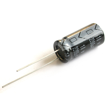

Sorry I figured you guys would know the short hand, cap is short for capacitor, one of these:
