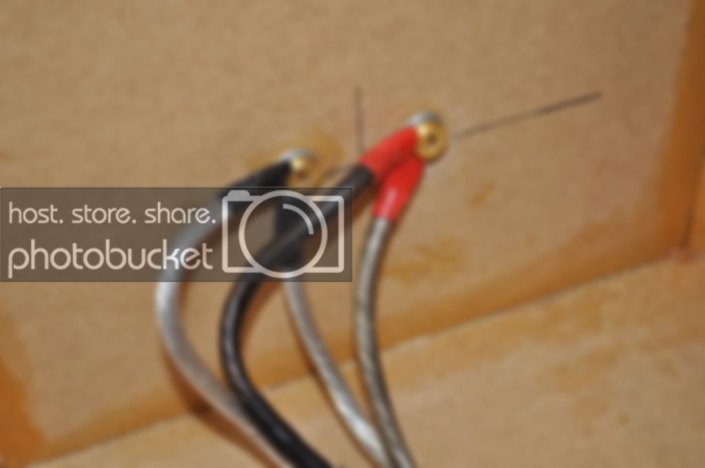

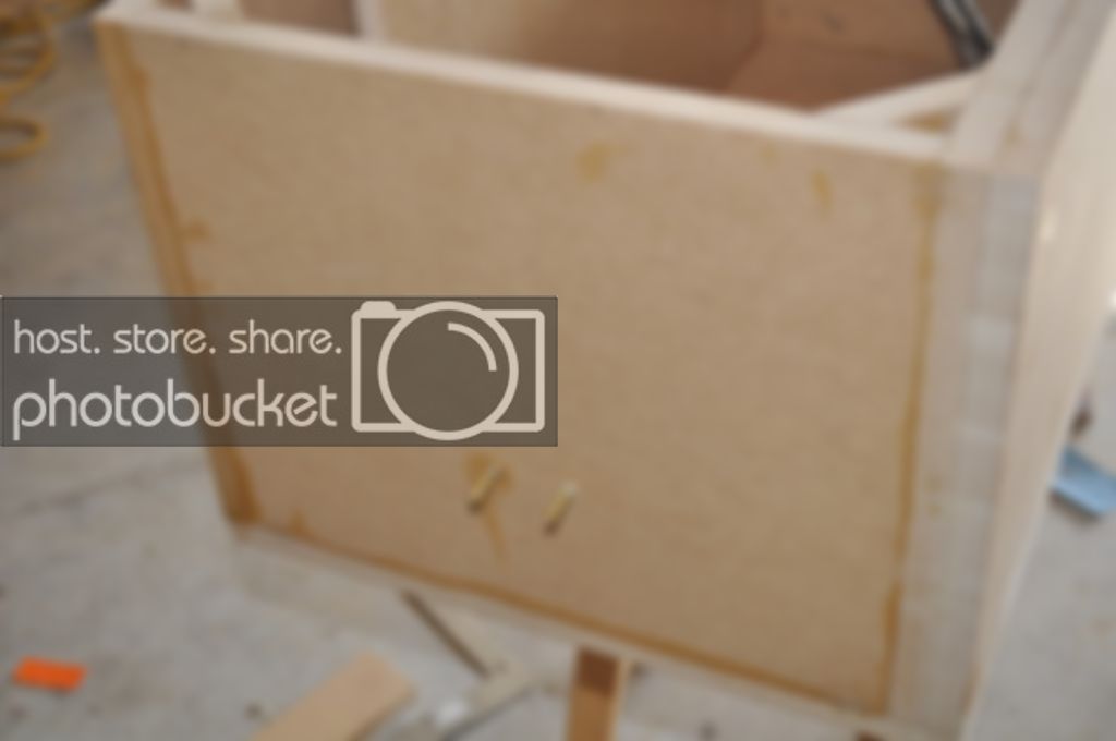

Buy these from home depot. SKU # 608576
1/4-20 x 20mm Zinc-Plated Steel Type-D Insert Nuts (4-Pack)-54454 at The Home Depot
Drill a hole a little smaller than the insert, apply some wood glue and twist them in with a hex head. There will be absolutely no leaks at all when you use these screws from Home Depot. SKU # 254827
1/4-20 x 2 in. Coarse Brass Flat-Head Phillips Machine Screws (2-Pack)-30171 at The Home Depot
I'm very happy with the way mine turned out
