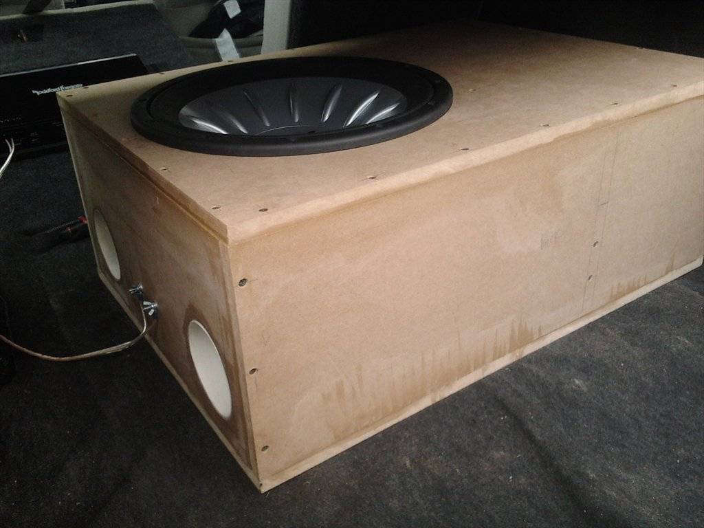

I use 1 1/2in long 10-24 bolts with wing nuts.

naw dude compared to port opening its no a big deal at all. The bolt/wingnut route is also a good option
I ran 8g to my JBL sub and i drilled 2 holes for it. Even though 8g is rather large both of the holes didnt make any noise. After you run the wire threw not alot of air can come out it. It was on 800wrms for reference
You can get set screw ground lugs that will basically give You amp-like terminals with the bolt idea (instead of ring terminals). They sell them in the electrical section at most hardware stores. I have a pic on my home comp but I'm on my phone...
