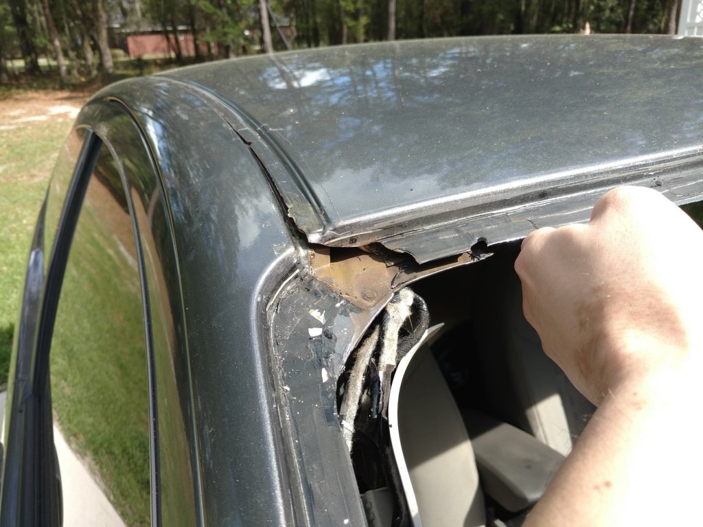

Stupid loud breaks shit. You okay with that? :ROFLMAO:
Not in the SRT
Then you aren't going for stupid loud. You start flexing the sunroof rails at 120db(using a Dayton AMM 1 mic, not the most accurate). I'm probably in the 130s down in the 20-30hz range and I've bent my trunk hinges already.
Stupid loud will bend and break things, if you aren't OK with that then stick with a pair of low-power 10's or 12's and make it sound good.
Matt
