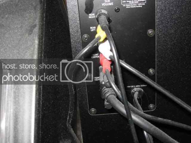

4.) When i get this plate amp can i hook it up to my computer? or do i have to buy a reciever and just be able play cds? I already have computer speakers with a sub im thinking i can use for mid bass if my sub setup hits the lows.
Heres the behind of the sub that came with my computer speakers:

What are you goign to be driving the plate amp with? Computer? Reciever?
Honestly, I wouldn't drop too much cash-o-la on just a computer subwoofer system because it will EASILY out drive most computer speakers of just about any type.
