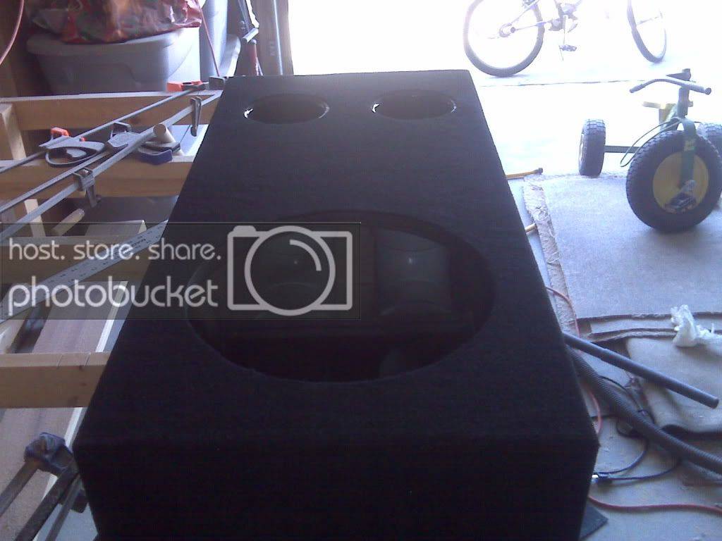

Against better judgement, i'm gonna post it up any **** ways.
Box build for Got Bass? and for the record, Twisted and I are cool

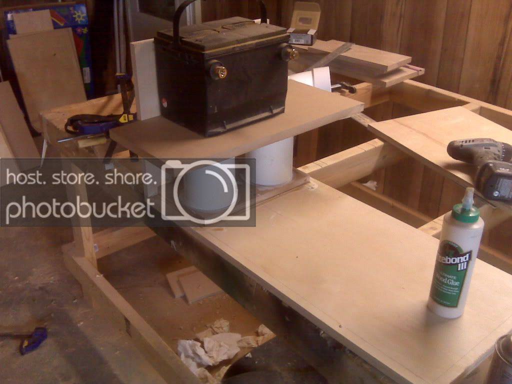

2.5net@36 htz with 2 4" homemade aero's....not a huge flare like PSP aero's but a roundover flare. Baltic Birch BTW
whats the problem? looks good to me? just make sure you answer his PMs in time.//content.invisioncic.com/y282845/emoticons/smile.gif.1ebc41e1811405b213edfc4622c41e27.gif
I call that friggin ingenuity. How's it sound or have ya got to try it yet? I've been intertaining thoughts of a box similar to mine but with aeros instead of slot port. I would be nice to have interchangable ports for tuning.
it has more output and no port noise,from now on,its only aero's for me !
i just built another box similar to this one where the guy plugs one of the ports for daily and unplugs it for burping
