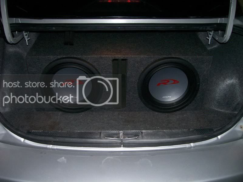

it was prefebbed here is a pic
duel chamber also
here are the specs i found from the person i got it from
BASS12-SEP-VENTED
BOX MEASUREMENTS
LENGTH 36 INCHES
WIDTH 16 INCHES
HEIGHT 13 INCHES
ENCLOSURE HAS 1.26 CUBIC FEET
OF AIR SPACE PER CHAMBER.
SUBWOOFERS ARE CHAMBERED SEPARATELY.
PORT IS 13.5" LONG WITH 35.25 CU.IN. OF AREA.
5/8 MDF INDUSTRIAL CONSTRUCTION.
CHARCOAL GREY INDUSTRIAL GRADE CARPET.
TWO SPRING LOADED SPEAKER TERMINALS.
