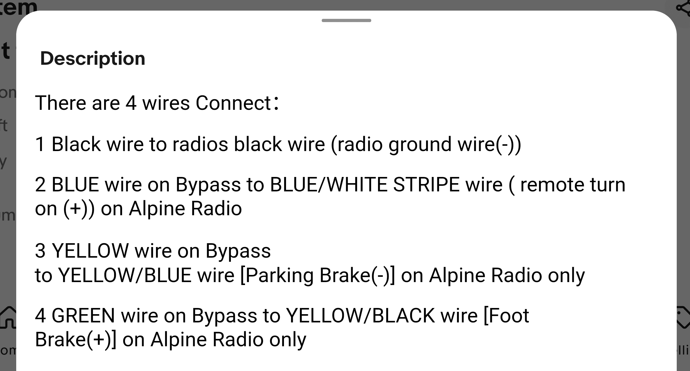

I have an 09 vw jetta. And put an alpine ilx w650 in. The only thing I can't figure out is the parking break Wire. Can't find out ware except for @the parking break. And to do that I'd have to rip the whole center console out. I also bought a bypass because it locks you out unless your parked. And for that it needs a brake pedal wire. Have no clue ware that is either.
If anyone has installed this unit in a vw and knows ware either wire is that would be very helpful.
Bypass has 4 wires. Apparently specific to this head unit. Power, ground, parking break + and brake pedal -.
Does the radio have two brake inputs? If not, I would first try the e-brake wire. If it does not grant you video access, then try the brake wire.
Just found this in eBay
