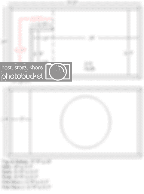

And as a second question, I wanted to create my ported box for it I was wondering if anyone had tips on the design or knew where to find a schematic?

*OFFICIAL* Free Ported Box Plans (56k NO!!) - Dodge SRT Forum Here are free designs with cutout sheets, just cut it out, glue and screw, choose whichever fits your car. For the threatcon, 2 cubic feet tuned to 32-36hz works great.

Thanks for the advice guys //content.invisioncic.com/y282845/emoticons/smile.gif.1ebc41e1811405b213edfc4622c41e27.gif I'm going to give these pioneers a quick try and if I don't like them i'll return and look into others. I took a look at that link for the boxes but I didn't see a 2 12" box for 1.5 Cu.ft at 37 hz
because that would only give .75 cubic feet for each sub which is barely enough airspace for 8s basically will sound like sh*t because the sub is suffocating.

Oh sorry I meant 1.5 CU per sub
Closest you'll get
3 cubic feet total at 35hz thats 1.5 per sub.
The box can work for a 15 or two 12s
Crap, I just realized my trunk is only 35" wide. And I need a design for 2 subs //content.invisioncic.com/y282845/emoticons/frown.gif.a3531fa0534503350665a1e957861287.gif
http://img.photobucket.com/albums/v340/Creatre/Box%20Plans/295cubes34hz3625sqin2dd.png
http://img.photobucket.com/albums/v340/Creatre/Box%20Plans/35cubes30hz465sqin0cb.png
http://img.photobucket.com/albums/v340/Creatre/Box%20Plans/35cubes32hz5425sqin5gq.png
Just because it has 1 circle does not mean its meant for only 1 sub you have the space to cut two 12" holes on each design man. If you need a higher tuning then shorten the port an inch or two, it'll give more airspace. The more airspace the better.
