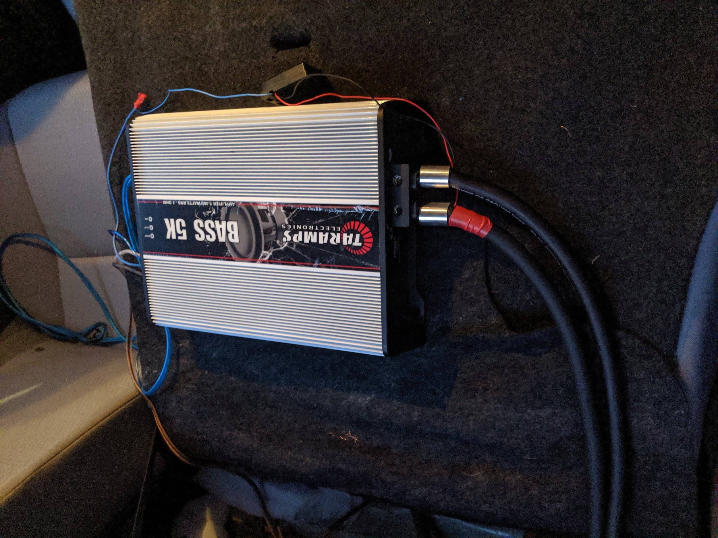

Ain't she purty!?!?!

Funny thing is that my voltage isn't dropping anymore than it did with the taramps hd3k.
This thing slams my xfls
What’s the difference between the bass 5k and the md5000
I asked the seller on Amazon that exact same question.
Here is HIS answer "The frequency response and the output filters are different. The Bass and MD series have different tones, so the sound output will be different"
I bought it because it draws 209 amps max consumption and the md5000 draws 245 amps max.
MD is rated at 12 volts and 60hz
Bass is rated at 14 volts and 40hz
MD is full range
Bass is not
MD can run up to 16 volts
Bass line can run up to 17 volts
MD line should not be ran under 1 ohm
Bass line can run under 1 ohm.

Hey man I got a question. The power and ground have 2/0 inputs right but im using my 1/0 to 4 ga reducers as seen in the pic. Is that a bad idea? Should I remove the reducers(voltage is fine)? I feel you almost get a better connection because it's so nice and tight with the reducers.
