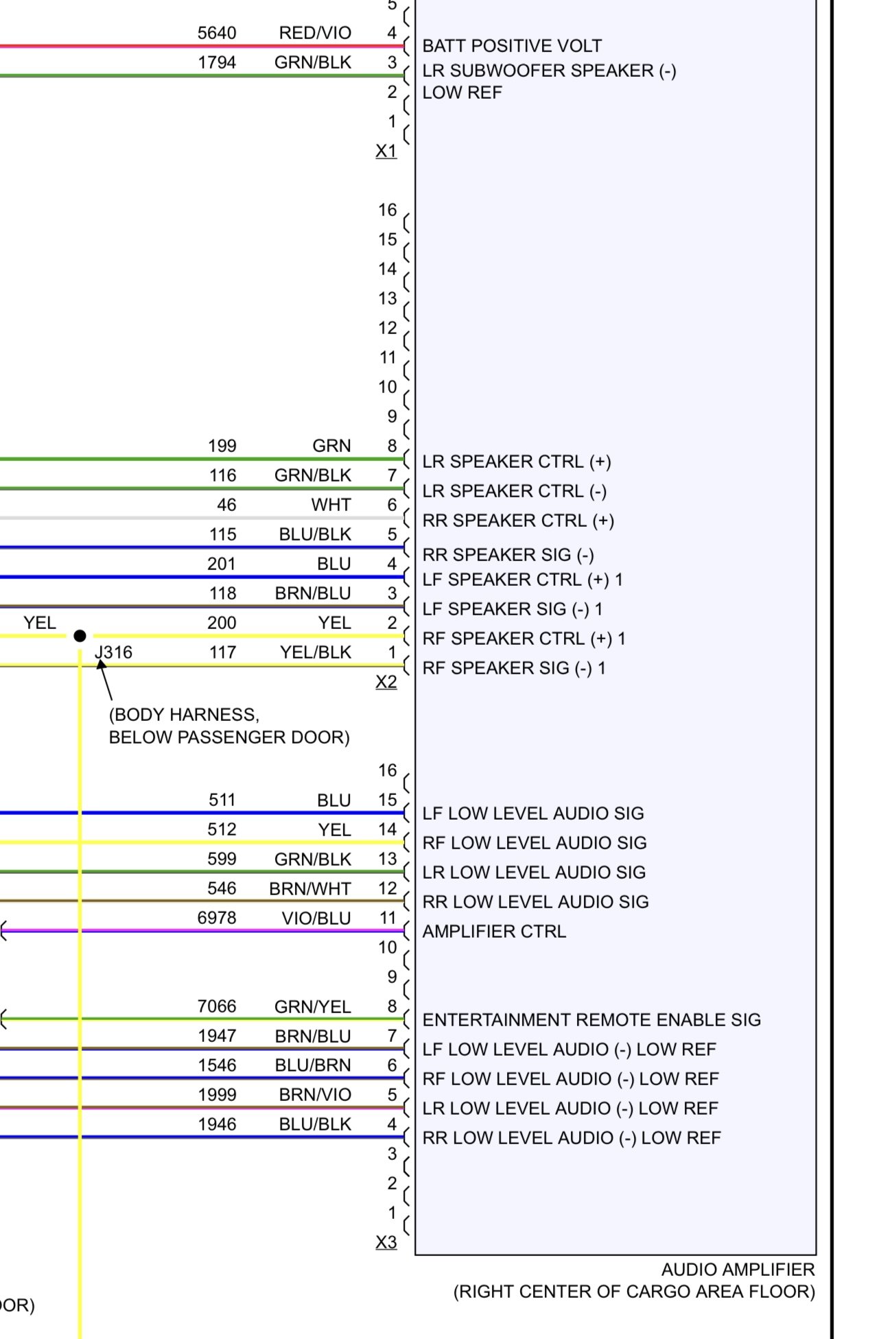

I’m attaching a picture of the wiring diagram that goes into the Bose amp.
1. Do I splice into the wires before or after the Bose amp to get signal to my Rockford R250X1 mono amp?
2. Should I splice into and use the high level input on the amp using a Molex connector or splice using RCA cables to plug into the RCA inputs?
3. Which wires should I splice into to get the best signal (front/back?)
4. Do I need to use a low level converter?
thank you for your time.

Splice before Bose amp, front channels. This way you get a full signal and let the amp do the filtering. Also you will have the full signal for when you add the full range amp. Use an DSP LOC. It will clean the signal better than the amp's built in High Input.
Thank you so much for the reply. If Only for the meantime to save some money could I use a cheaper loc just to get the amp and sub up and running then purchase the dsp when I’m more prepared for the full system overhaul? Would the recommended pre Bose amp front wires still be the recommended wires? Ie one of those cheap kicker loc’s. It’s a new to me car and my shopping list is super long. Would like to get the amp and sub going then work on other things like tint, seat covers, floor mats (live in a rainforest) and wheels and tires before coming back to the stereo.
Late reply, I did not get a notification. It would not hurt to try a passive LOC temporarily. It may work good for all we know, best bet is to try it. You can also use the rear channels for a signal source, they should be playing a full range signal. All pre amp of course. I cannot even begin to imagine how living in a forest is like. Spooky is the first thing to pop on my mind.
