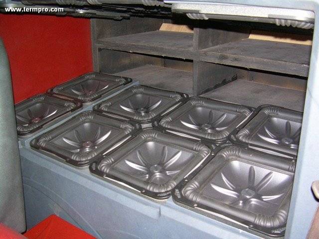

hmmm.... what do u suggest? i mean i def want the 12's to be ported maybe design it like wills truck? instead of how frankies car is?
Now, in Potts case.....
He built a solid shell, fired the subs down and the aeroports back. That install was sick as all hell... 53's under 30hz w/ only 1 2500D and 2 typeR 12's.
Keep in mind, he tore it out and tried to duplicate it the following year only to fail.
i was thinking just like that but instead of the slots i would use aeros
I thought he tore that out?
I'm not saying don't do it, just don't plan on it working out of the box.... stuff like that is tricky.
Here's mine... did a 53 @ 26-29hz and did a mean hairtrick.
4 15's and 2 zx2500.1's @ 2ohm
u used aeros in that box too right?
Nope, the boxes were slot ported at the bottom rear. I was going to rebuild w/ aero's but ended up with a regular wall. All 4 subs on the passenger side and a narrow drivers side port.
156@41 hz and an even nastier hair trick.
Then I tore that out and did 3 subs with a bottom port the week before finals = fail. 153@46hz:furious:
The first thing I did was 4 10's in that same shell the 15's are in except I used aeroports. The note was higher(49hz) but it was still pretty nasty. 155 w/ an opti 4000d.
so what do u think i should do for what im going for? 4th order,ported like wills truck or something else. all i really want is for my truck to be impressive and pull mean hairtricks thats why im going with so much cone area and power.
