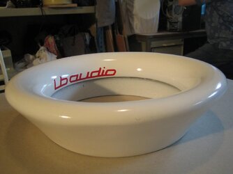

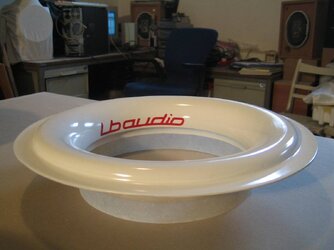

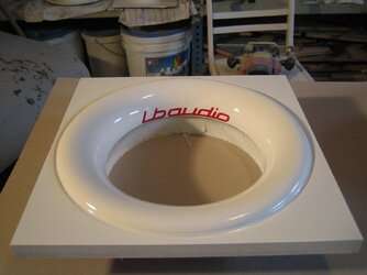

Round ports are more efficient compared to square or slot port with the asme port area, they are easier to retune if needed too. On the pics, those are mine production  - SQ 125 mm (5"), also have 8" for SPL comps
IMG_0439 125 aerro komplet f:r.jpgIMG_0356.jpgIMG_0351.jpgIMG_0333.jpg
Those are sweet looking!!! I guess you make them in different sizes and colors? What does SQ 125mm mean? Depending on my box I may use a 3 or 4 inch.
