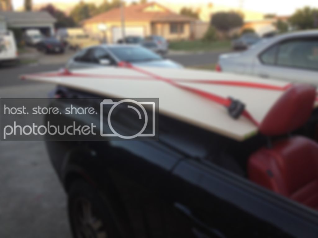

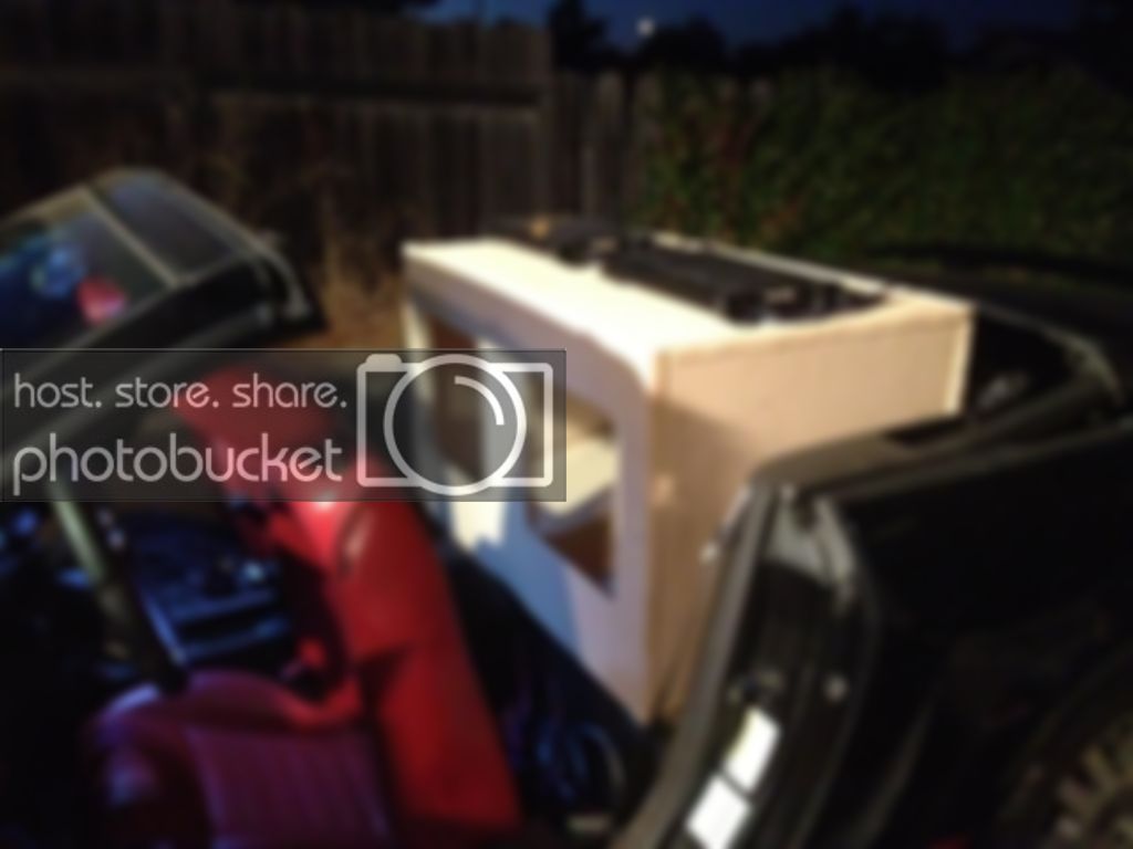

Here's some pics for fun:
Transporting my mdf
The box half way in
