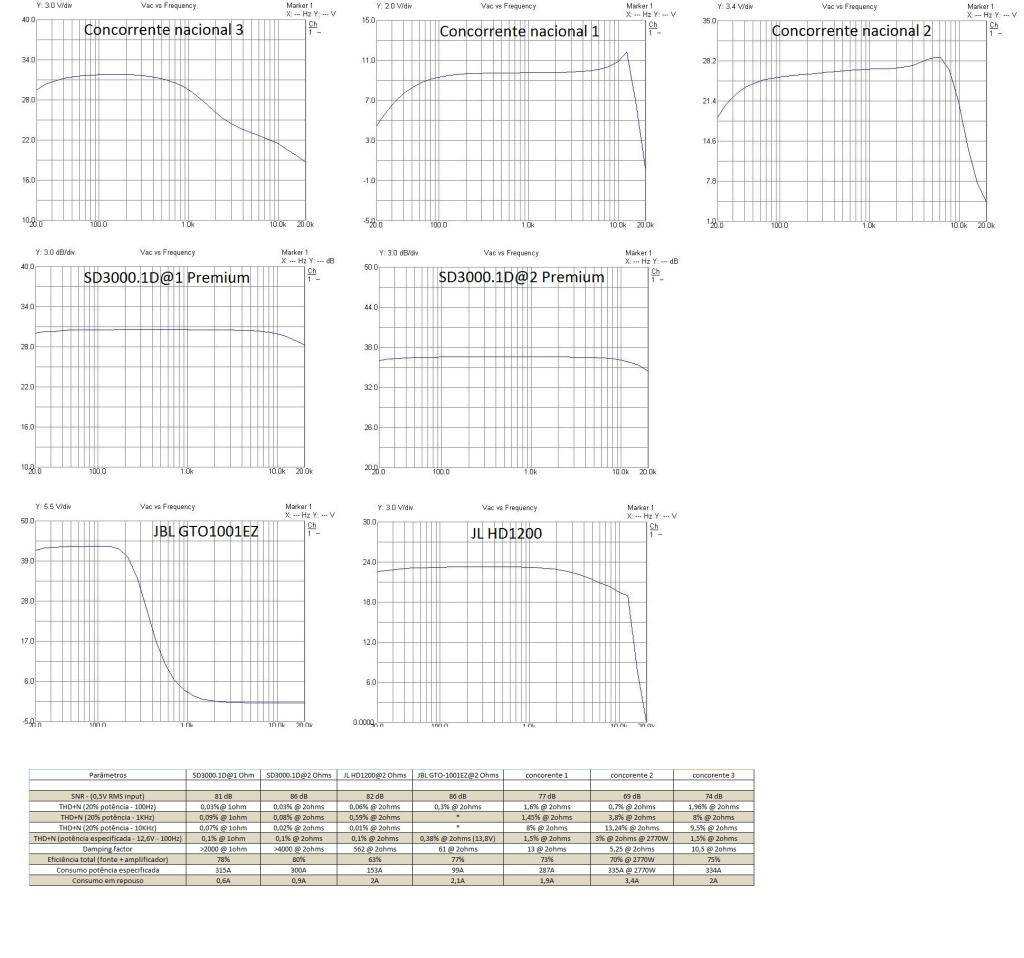

Didn't they clamp less power as the frequency dropped?
there's a drop on some of the lines below about 30hz, it's about a few volts drop but i dont see why it couldnt be eq'd out. im unsure of the amount of audible difference there is for a few vac
no one really knows which exact lines, i asked. all i got out of it was that the new dsp line is flat from 8hz-20khz or something
Brazilian amp low freq roll off - Car Audio Classifieds
The DSP is flat from 8Hz-20kHz and the HD is something like 10Hz-15kHz
The low end lacking came from the Banda amps that came with a subsonic filter that only went down to somewhere around 30-40hz so they dropped off really bad down low, but they were replaced with a lower 17Hz subsonic filter with a small update to the parts used
I can't speak on the T series frequency response because I have not used them and don't recommend them as they are the ones known to cause problems.
