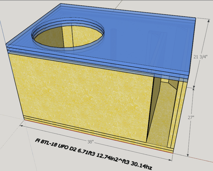

Ok noted. I'm trying to figure out how to get it down to 30 hz
Just scrap it and start over. Use the proceeds to invest in some nice birch or pine plywood. A double layer of that stuff all the way around will be stronger and weigh less. Aeroports might be a better option for you as well. They don't take up as much space and are easier to design around plus you can tune on the fly by adjusting port length even after the box is built. 2 6 inch aeros or a single 8 would be sufficient.

What do you think about this?
I only use aeroports, I cannot stand slot ports so I'm not the one to ask if you insist on using a slot port.
It's not that I'm against it I just haven't done it yet. By the numbers I punched in it looks like I can get away with 2 6 inch round ports with good optimum port. velocity. I might just do that because no matter what I do for a slot port I can't make it big enough with good port velocity... I might just do that
Triple baffled, double walled and ported for your power... hope it'll fit in the space you gave...

Personally I'd go bigger but I feel it'll do just fine... I just wanted it to fit
Imo that calculator you're using isn't that great. Try ultimate car audio app. In my experience using it it's pretty darn close to winisd as far as port lenght,provided you put everything in right. Double check by measuring it yourself for the box volume .There's some advantages using aero ports. You'll get some more air space and it's more efficient then slot. You don't need as much port area.

Yea man that looks good. It looks almost identical to the box I have right now other than the port slot making that turn a few inches

That looks almost identical to my box other than the port taking a turn
