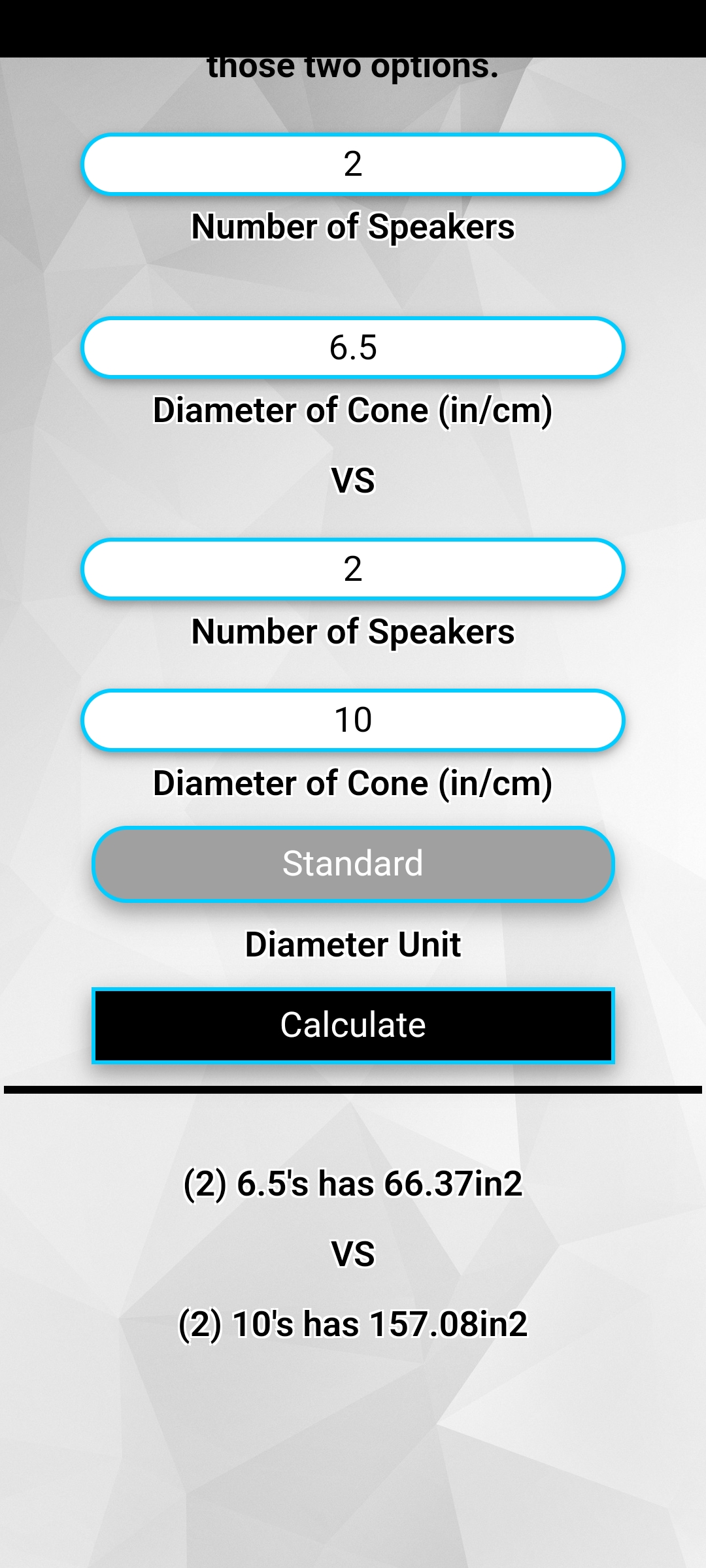

I was considering to changing my subs to two 10in slim subs but don’t know if that would be any louder I never had slim subs.
That's a rough estimate of total cone area but it's a dramatic difference

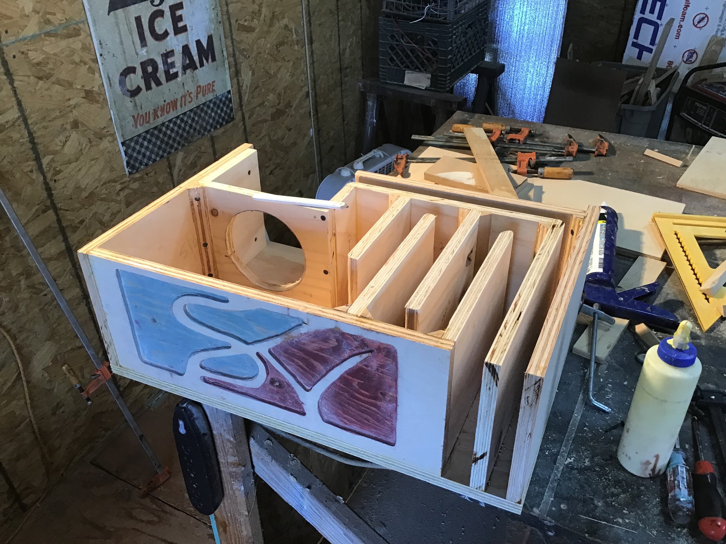

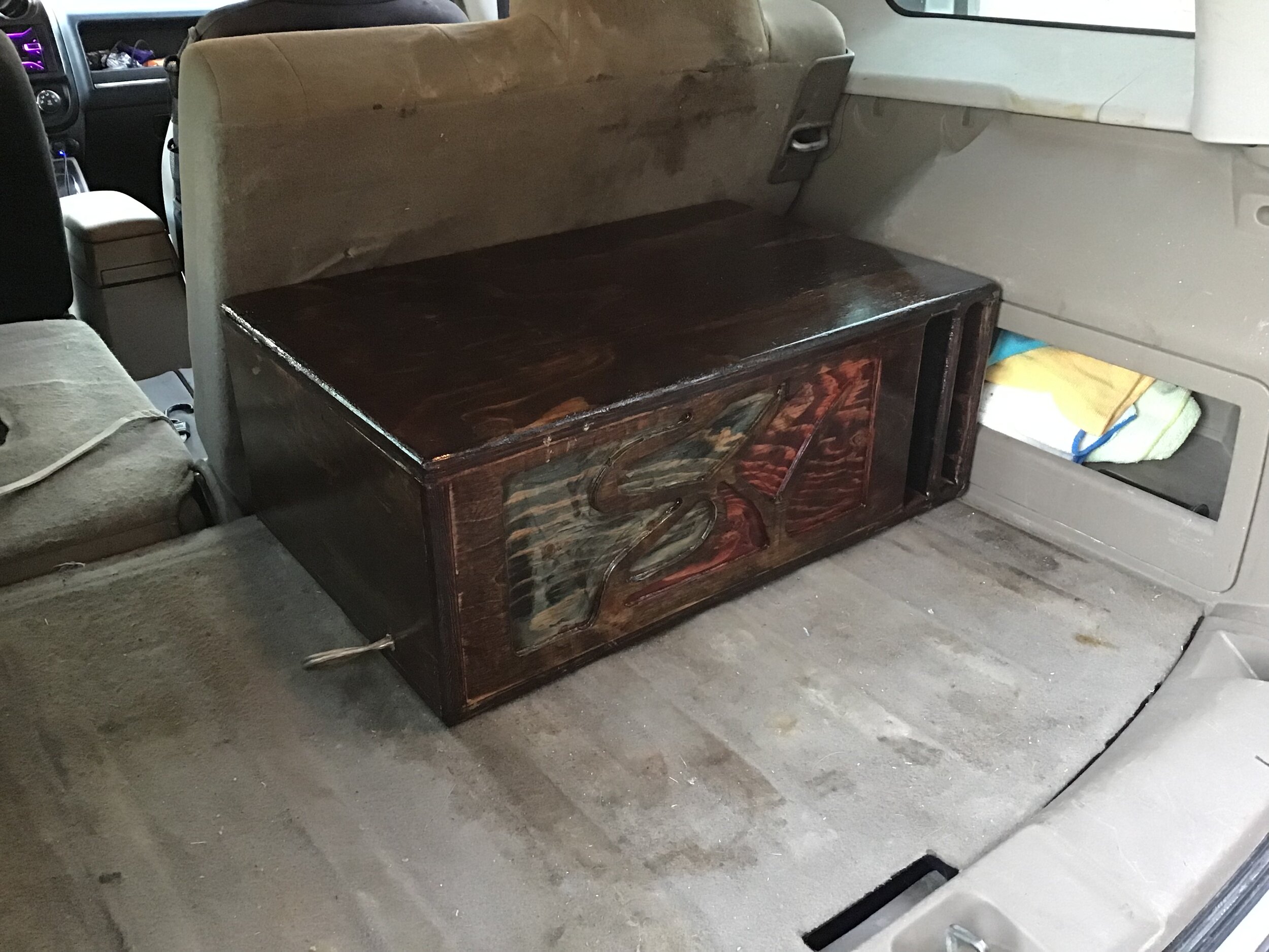

Those Savard 6.5s do very well in a ported box. I’d take them over a shallow mount any day, aside from the JL TW5 shallow subs. .5 cubes per sub tuned to 34-37 HZ works very well with these. They will also handle a bit more power than the 350 watts depending on the enclosure. The Savard 6.5s and the RDS 6.5s are very impressive small drivers.
This is a single RDS 6.5. RDS performed very similar to the Savard in my testing. It actually did well even in an SUVs large cabin. It performs even better on music than test tones, but the test tones show how much air these little things actually move. In the right enclosure these 6.5s will outperform most shallow mounts in the same air space.
That’s the little single 6.5 inch enclosure. The Savard did just as well as the RDS. These subs do well in ported or 6th orders but not as well in sealed or 4th order boxes. Definitely a ported box subs.
