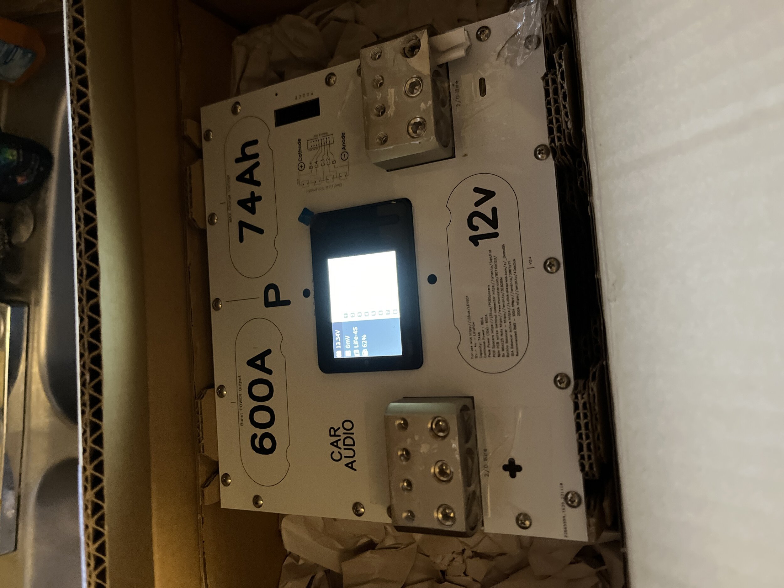

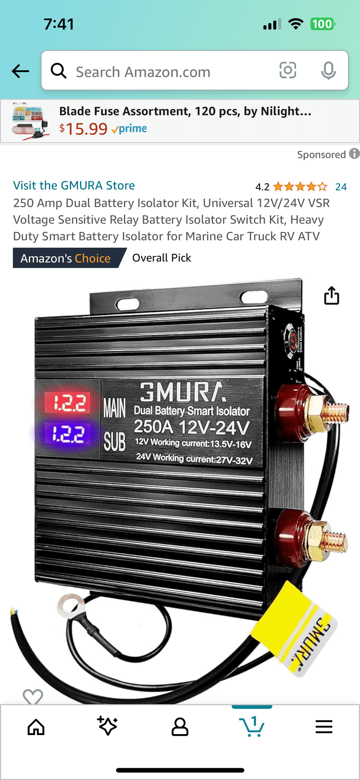

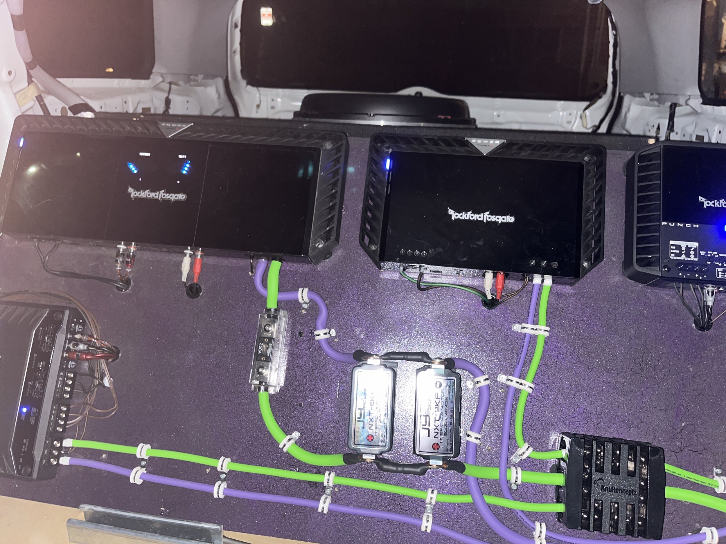

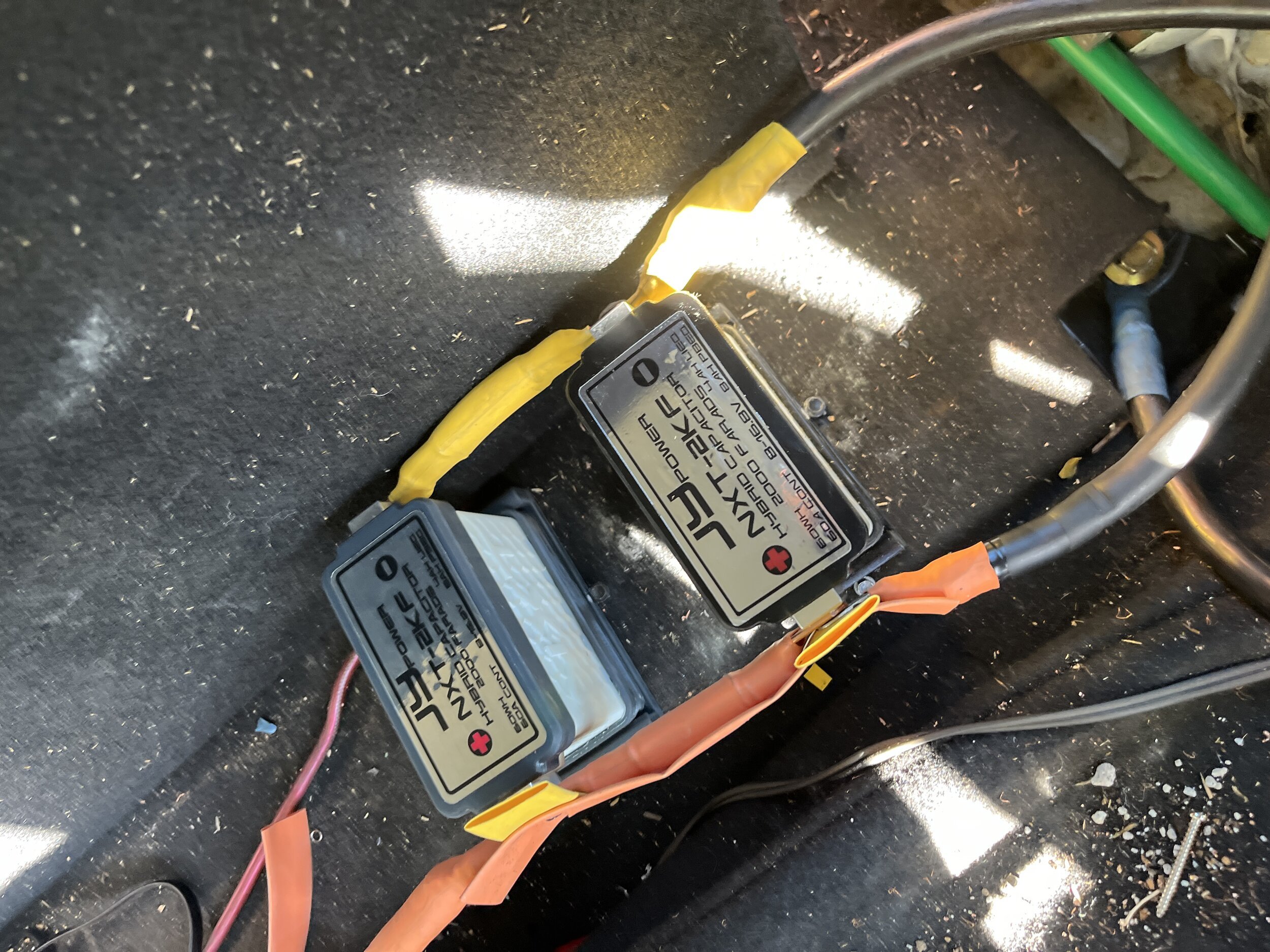

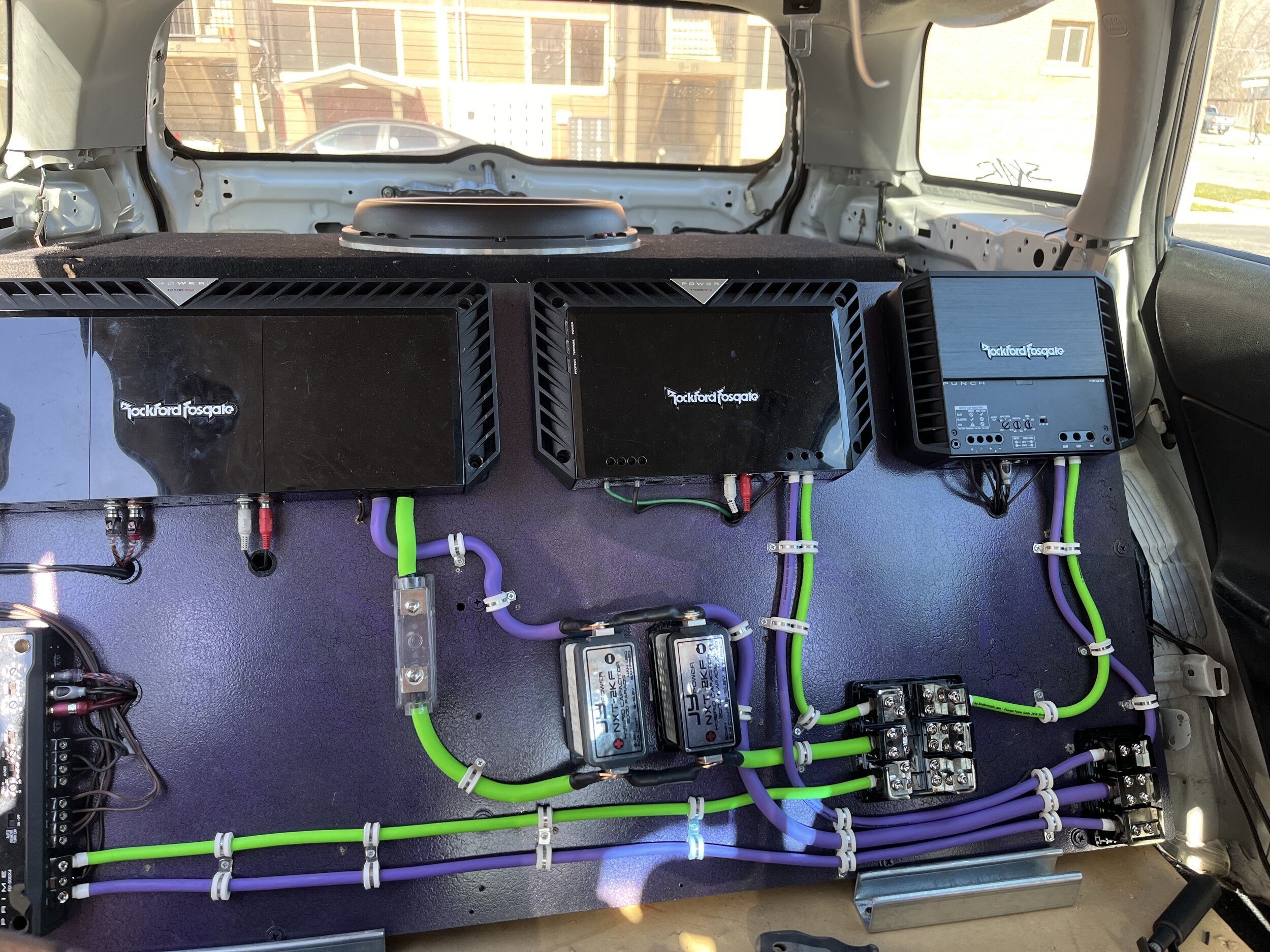

i am adding a 64 ah 600 v 7200 w lifepo4 battery bank to my system i have a 110 ah agm up from i have a 250amp isolator 160amp alternator i have the big four will be running 2/0 wire what else will i need to install to help my lithium bank i was thinking about leaving the 105 ah agm that i have in the back as well as add the lithium bank but i think that could be over kill i am running rockfordfasgate 13”t2 with the rockford t2500amp 2 kicker l7 10” on the rockford t1000 4 skar npx65 6.5 on the rockford r2500x4 2 skar super tweeters ona punch 300 2 chanel also have 2 jy hybred super capacitors 2000 faired each they run to the t 2500 only would add pics if i could figuer out how
that’s my system first is isolator then my bank my amp rack and subs
It is a little overkill with the batteries, but underkill with the alternator. Ideally, you want an alternator that will keep up with your system and your car. You might want to have, at least, a 350 amp alternator. You're batteries don't mean much if your charging system can't keep them charged. That goes the same with the system's performance. Keeping a steady 14.4v will give better performance.
