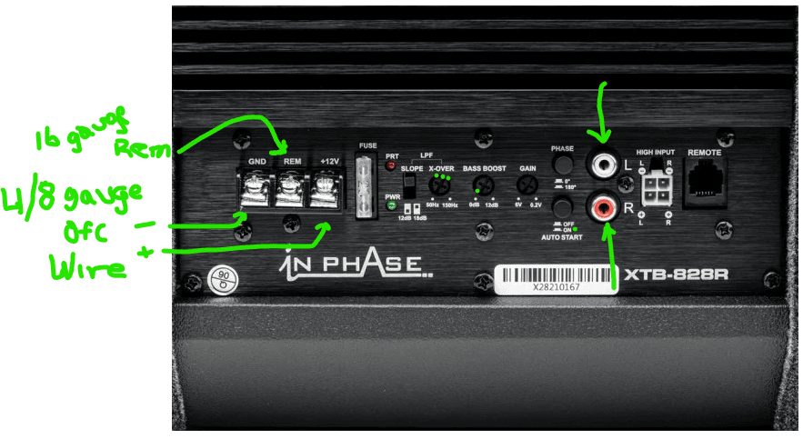

As for the wiring, pretty straight forward. Get a 4 or 8 gauge OFC wiring kit for power/ground. As for the rest, all you need is a long pair of RCA cables, L/R. They will go from the subwoofer outputs off the deck straight into the back to the L/R inputs on the powered sub. These will do fine. I did my searches on Ebay UK. if you can find them for less, just make sure they are shielded/twisted pair RCAs that reject noise.
I believe that if you use that Auto Start feature (ON), you won;t need to run a remote turn-on lead from the HU to the amp as it will sense the signal from the RCA inputs and turn the amp on. Sometimes they don;t work as advertised and the remote is needed (cutting off to soomn when signal is not present, or just not working as they should). Personally, you have the HU out and it has a dedicated remote turn on lead, that is the route I would take, remote out from the HU to the remote lead in on the sub. Make sure you select the Auto Start accordingly.

Here in green are some pointers.
