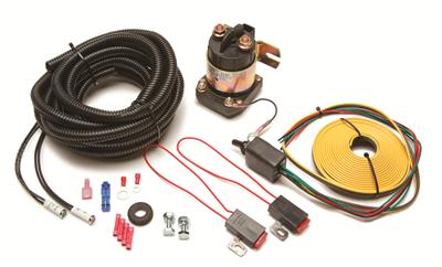

anyway for the whole relay thing here ya go:
"Easy way to control your dual battery current.
These Painless Performance dual battery current control systems include a three position switch to control the second battery through the operation of the solenoid. Switch position one isolates the second battery. Position two connects the batter while the ignition is on. Position three connects the second battery at all times."
Painless kit 100 bucks from Summit
http://store.summitracing.com/partdetail.asp?autofilter=1&part=PRF%2D40102&N=700+115&autoview=sku
