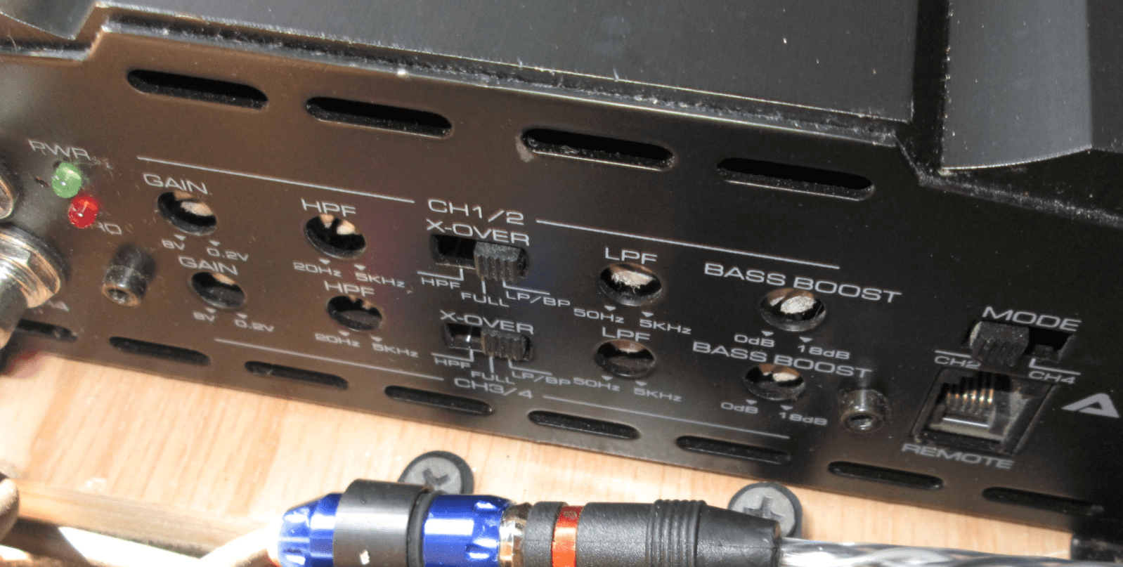

i honestly don't want to buy a 80prs or one of those fancy HU because it just seems very complicated. the sound processor is just too expensive so that leaves me with active cross over. Pleas correct me if i am wrong. How can i go active?
HPF 20Hz-5KHz
LPF 50Hz-5KHz

yea i only have a front stage as my truck is a single cab, the actual crossover switch for chan 1&2 goes on HPF and 3&4 on LPF?

Your mids you will use lp/bp which plays between the lpf and hpf. For tweets use hpf and set the hpf.

You can use HU crossovers and amp crossovers together but they will try to overlap each other, and whichever has the steeper cutoff rate will take over. Using the amp's crossover is fine but you're pretty much guessing with those knobs and might take you forever to get right. If your HU has active capabilities, then it's best to just use that and set the amp to full range. A processor will be much more precise and easier to work with because you can change anything in a click and compare them on the fly. You will spend forever going back and forth trying to adjust the knobs but it can still be done.
