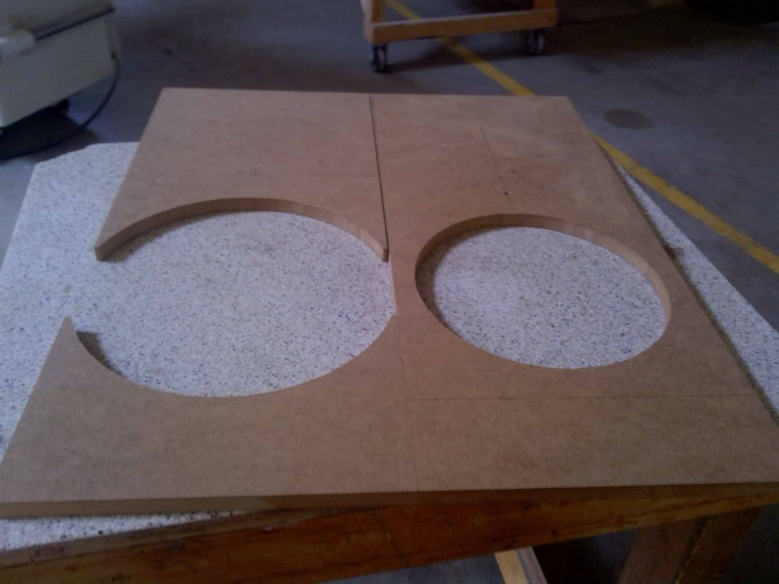

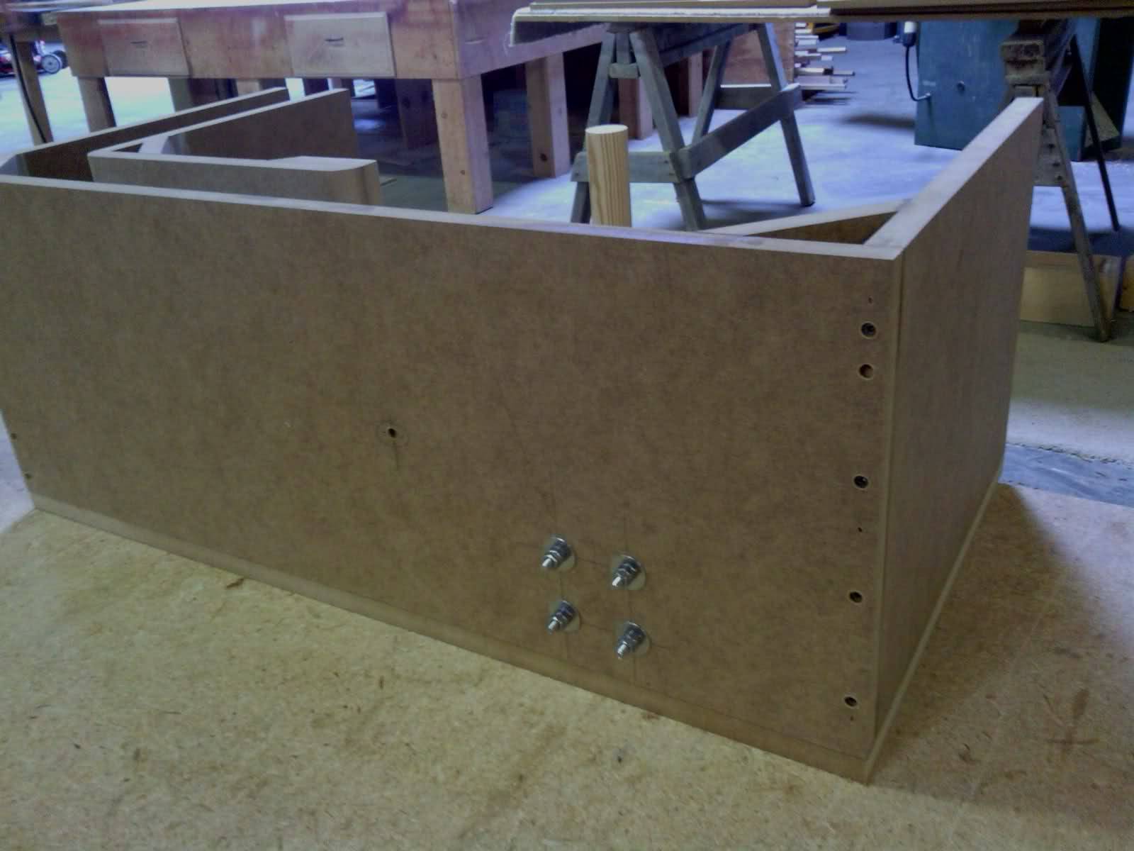

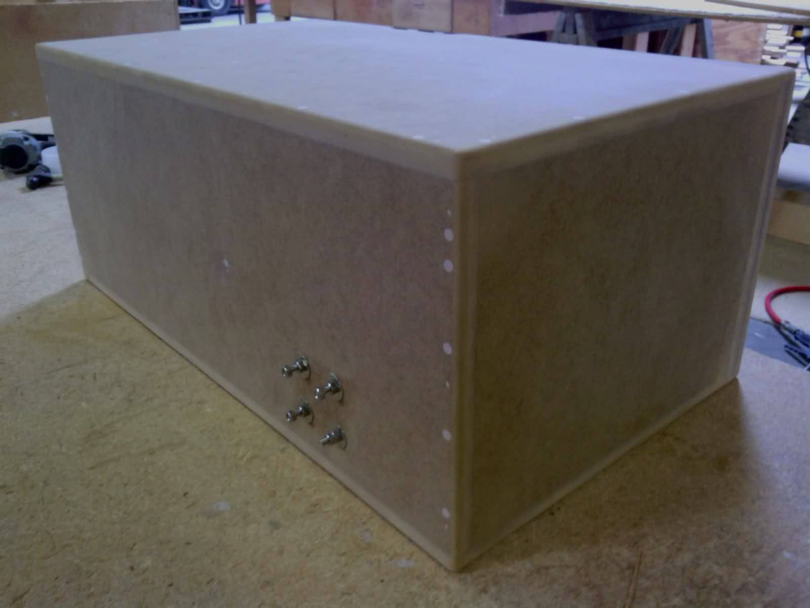

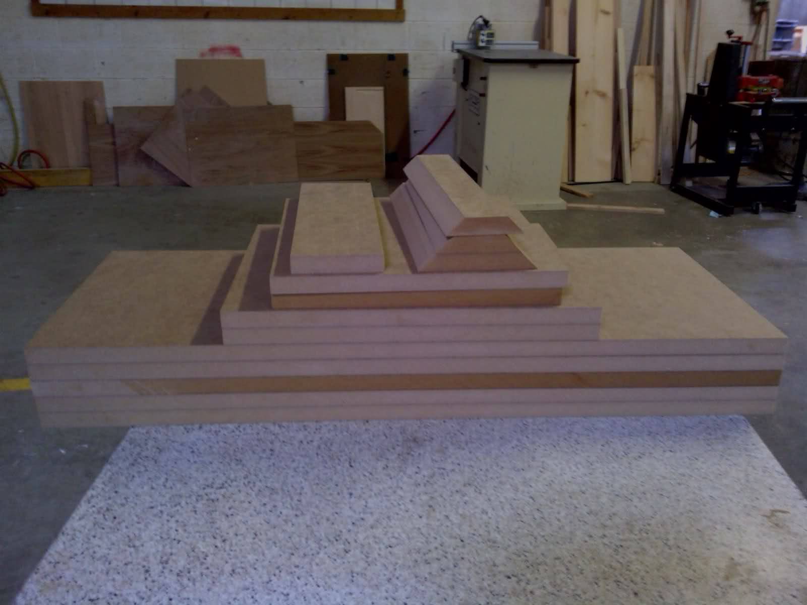

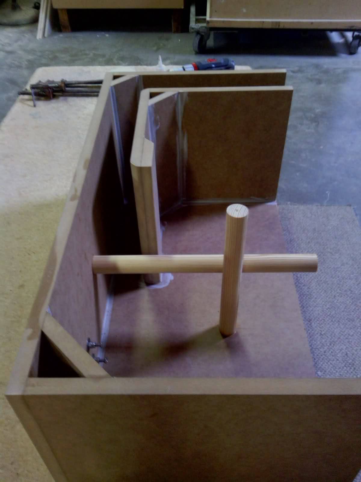

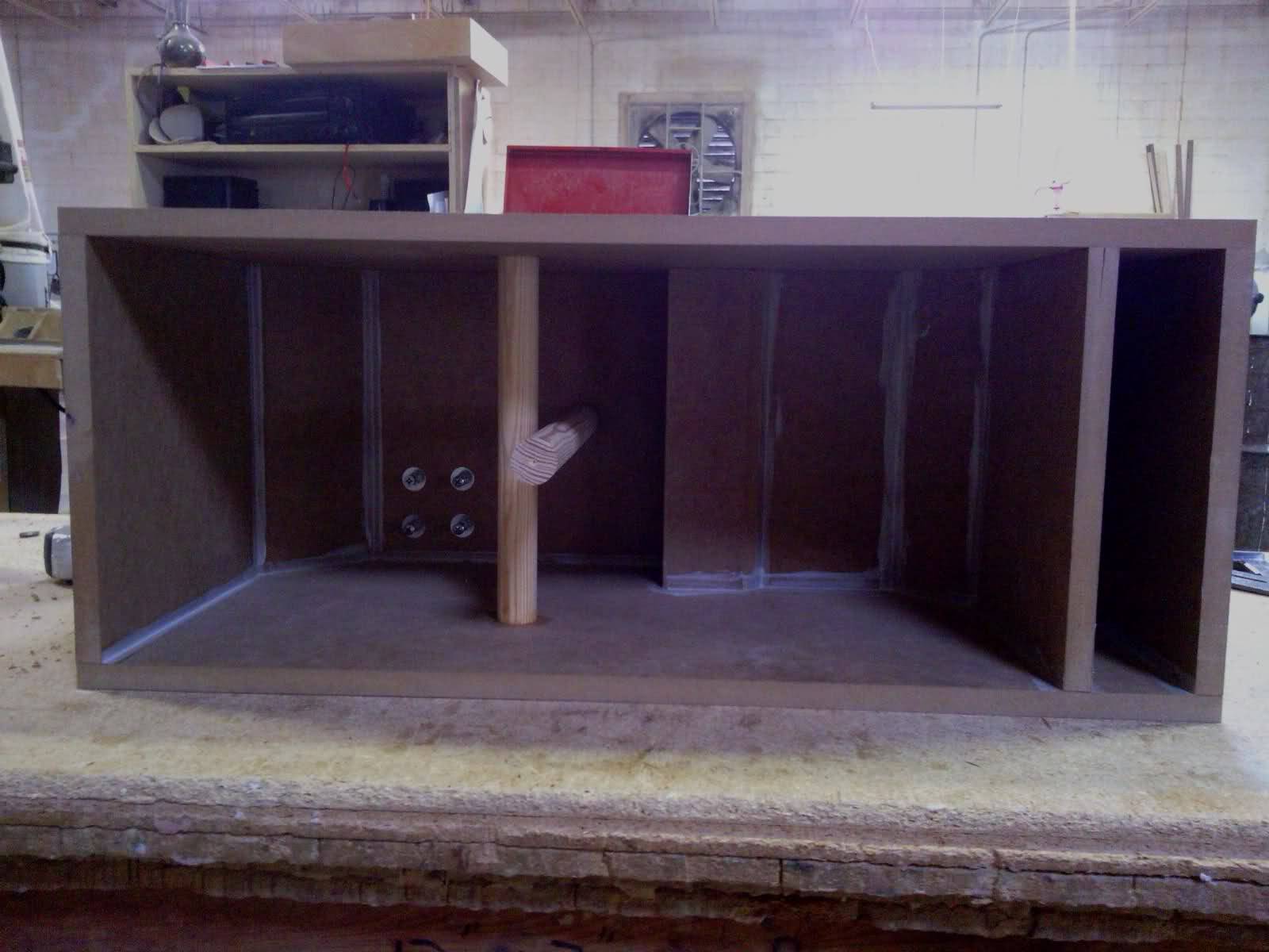

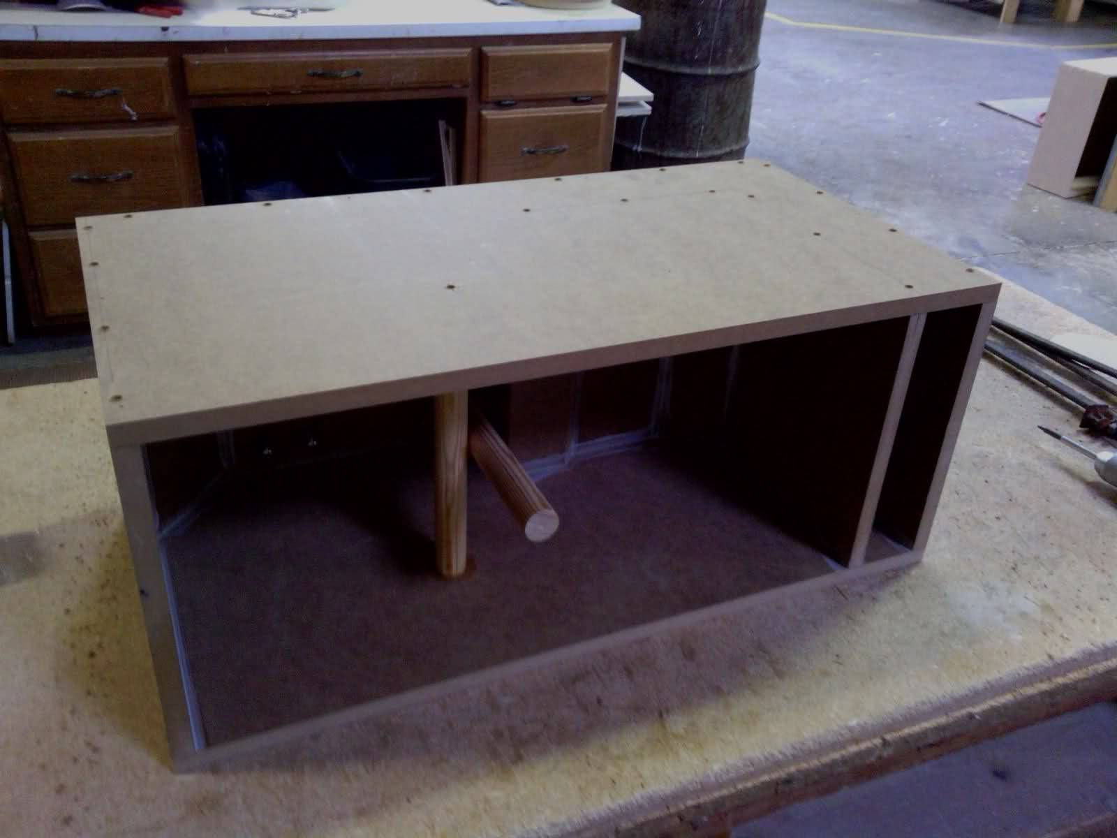

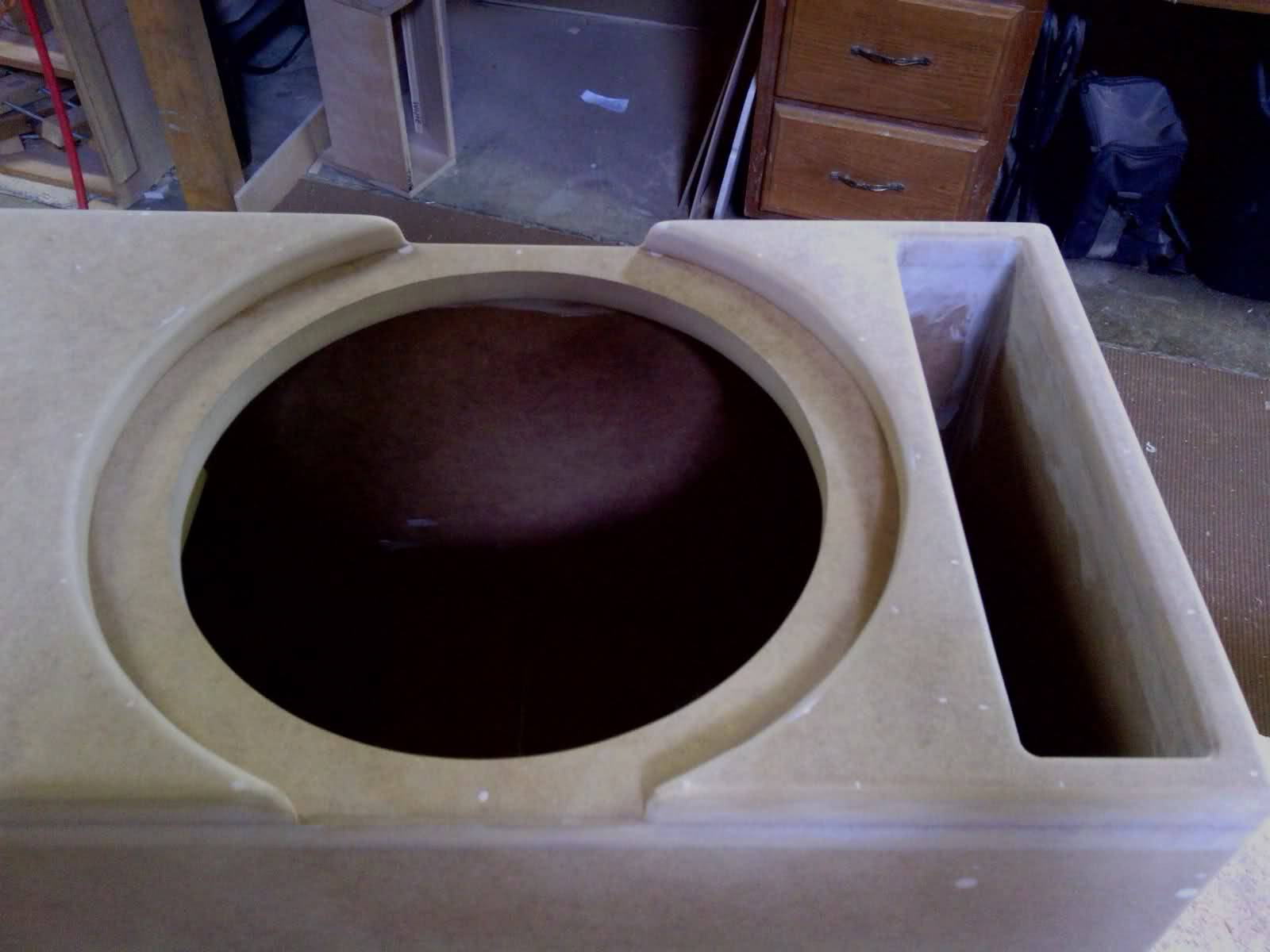

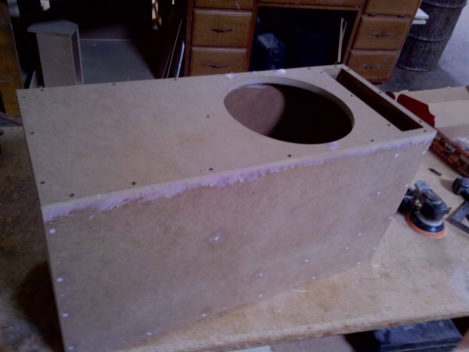

I'm building a box for @rebelfromva

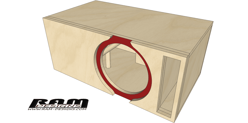

Ram-designs.com designed it.
It will be for an American Bass XFL 12.
The box is going to be 2.45ft^3 tuned to 33hz
---------- Post added at 08:16 PM ---------- Previous post was at 08:15 PM ----------
More Pics
I'll finish it up tomorrow.

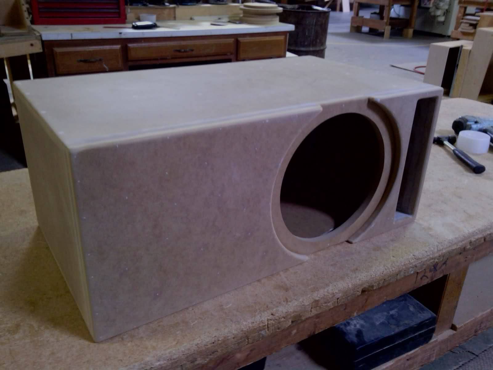

looks good //content.invisioncic.com/y282845/emoticons/smile.gif.1ebc41e1811405b213edfc4622c41e27.gif
Thanks man.

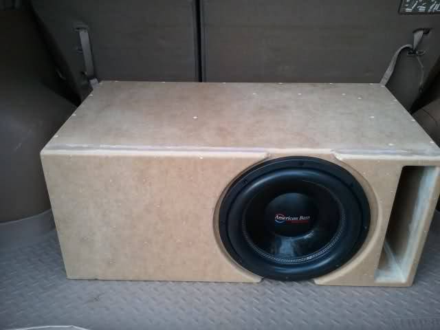

Can anyone verify these cutout dimensions for an XFL 12? Can't find anything on AB's website--got these from a SMD thread.
Cut out is 288 mm or 11 3/8"
Total is 325 mm or 12 13/16"
Anyone else notice the shop? Most people would be in heaven building a sub box there. Awesome design and build. Cabinet shop?
yep. Jaydub, I just seen the finished pics and **** that looks amazing. Can't wait til you drop it off tom...
Yeah I had torn one down and used my digital calipers to measure coil size ID & OD and winding height and spiders all had it written down and had...

I have 2 of them in around 2.5 cubes per sub, tuned to around low 30s Hz. I think.its tuned a little low. Really low frequencies hit thick and...
