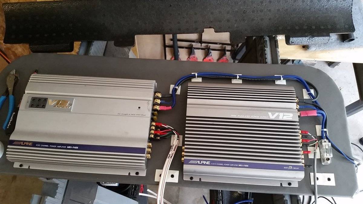

Lastly, plan on wiring the stuff neatly.  You want a board that everything will mount to.  You want to secure the amps with enough space to route wiring safely.  All positive wires get fuses.  Grounding locations should be to bare metal and tight.  Wire sizes should match fuses ratings that protect them.  Pictured is a sample amp rack I put in my wife's car.

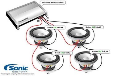

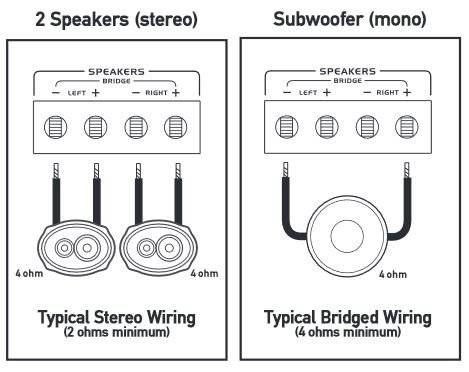

the wiring diagram above i would choose the 4ohm to 2ohm one for the sub . my question is out of the 4 speaker terminals on the 4 channel amp with that configuration do i connect the 2 wires from the sub to keep it at 2ohms configuration from above, do i connect the 2 wires to just channel 1,   or  positive to channel 1 and negative to channel 2 out of the 4 channels terminals. if that is the case will their still be 2 channels available on the dual 4 channel amp ?

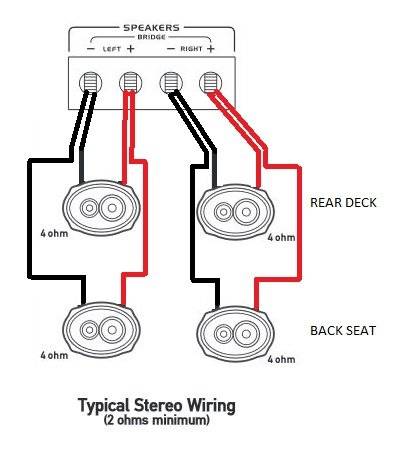

i have looked on the internet and i can only find this diagram for 4 speakers to a 2 channel amp but it is for subs will this aply for the 4 6x9?
if so it going to be a little tricky with the 2 being mounted in the upper rear and the 2 external loose in their boxes in the back seat but if this is the best for the encore as far as max rms output from the specs above mentioned am i right or is their a better way to wire them
i forgot to upload the picture of the diagramhttps://www.sonicelectronix.com/product/img/subwoofer_wiring/4_subs_SVC_4_ohm_2ch.jpg

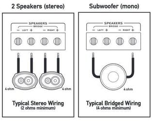

For the Dual brand 4 channel amp, you will wire it in bridged configuration for each coil.  The attached thumbnail is from the Dual XPR540 manual.
Channels 1 and 2 will be bridged to the subwoofer coil #1.  Channels 3 and 4 will be bridged to the subwoofer coil #2.  You want to get the gains set exactly the same - which is best done with a DMM.  To do this, you play a test tone (50Hz is ideal).  Then you measure the VAC (volts-AC) for each bridged configuration, getting them accurate to within 0.1VAC.
When wiring the four 6x9 on the Encore, you don't have to wire it like the diagram exactly.  Yes, all positives will combine but they can combine at the amp terminals.  So route wiring from each 6x9 to the respective amp.  On the Encore, you'll land two wires in each terminal.  For all other connections, you'll only have one wire per speaker terminal.  All speakers will only have one wire per terminal.

Maybe this diagram will help for wiring the four 6x9 two a 2 channel amp.  We would call this wiring left speakers in parallel and then wiring right speakers in parallel.
got thank you
