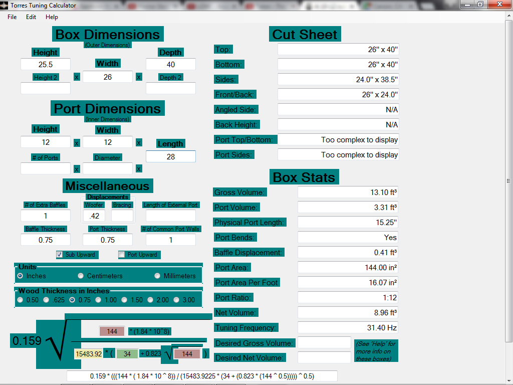

A 10-12 cubed box ported tuned to 30hz but highest 35hz
I have 2 hdc3.0 4ohm subs

2 hdc3 15's only need 9 cuft.

Lol I have one HDC 3.115 on a kicker zx 1,000 @1and clampped 1640 watts ran by 2 autocraft platnims and 0 gauge big 3 along with a 160 amp altenator I smash Lowes I did a 144.8 at 32hz don't hit Lowes my *** and those are the ext limits of how big the box could be in -WHL- so if there's a box with 11 cubes and its H29 inchs I can't use it to tall or say it ls width is28 I can't use it will hit the front seats the box is gonna be different then those specs those are just the specs it has to be in oh and my box now is circular ported with 8 inch wide 22 inch long 5.4 cubes inverted hdc 3.0 15 tuned to 28hz now I have 2 and need a 10 to 12 cubed box sealed or tuned 30-35hz sealed I will port my self why I say sealed it okay to ..
