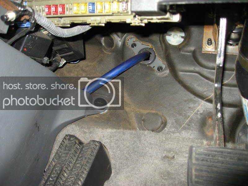

does anyone know the best place to run the power wire through the firewall in a 96 civic? i tried to find a place but could not figure out how to either find the opening on the inside of the car, or how to get the grommet thing out on the firewall. i would really rather not drill a whole...

it should be on the driver side above the foot rest.
i was pulling on it and i couldnt get it to come out... can i just run the wire under the car? what should i do to keep it safe and not drag?

you could run it under your car but its not a good idea.

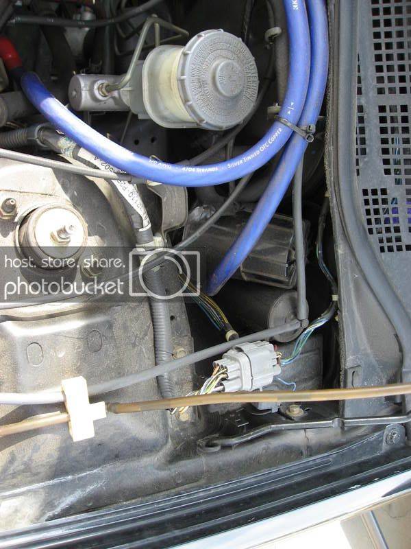

you should be able to pull it out grab a pair of pliers, what i did was i pulled it out and cut a hole in it so there would be no water leakage.
it should look something like this:

http://i108.photobucket.com/albums/n22/chunghoang921/firewall001.jpg
http://i108.photobucket.com/albums/n22/chunghoang921/firewall004.jpg
Im guessing thats where the clutch cable/pedal would normally go in a manual //content.invisioncic.com/y282845/emoticons/smile.gif.1ebc41e1811405b213edfc4622c41e27.gif
hmm, ill go outside and look again... did u take ur carpet off to run it? or does ur carpet just stop there, lol.
