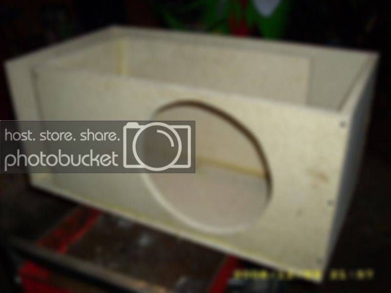

Ok let me start by saying this. Every thing ive learned about car audio had pretty much been from this site. And i try not to be one of these retards that post 45 post asking the same questions that have already been answered a thousand times as you can tell my post count is like 12. I had a CVX 12 D4 that was in a "professionally built" box that ended up being less than 1 cube ported to 55 hz, it was on a KX 400.1 in 2 ohm, i got it for free but it was damaged anyway. Thats where I started from. Before I knew anything about the enclosure I decided i wanted to replace the damaged sub. So i searched for weeks then posted up on here and ended up ordering a RE SX 12, D2 and a second KX 400.1 to strap with mine. Then i find out that my enclosure is firewood after i had already ordered the 12 //content.invisioncic.com/y282845/emoticons/verymad.gif.3f39c5c2fd57527b671fad3efdfac756.gif. So this is what i built. Keep in mind when looking at these pictures that I have NEVER built and enclosure before and I am not very good at woodworking in general (i cant cut a straight line for my life).

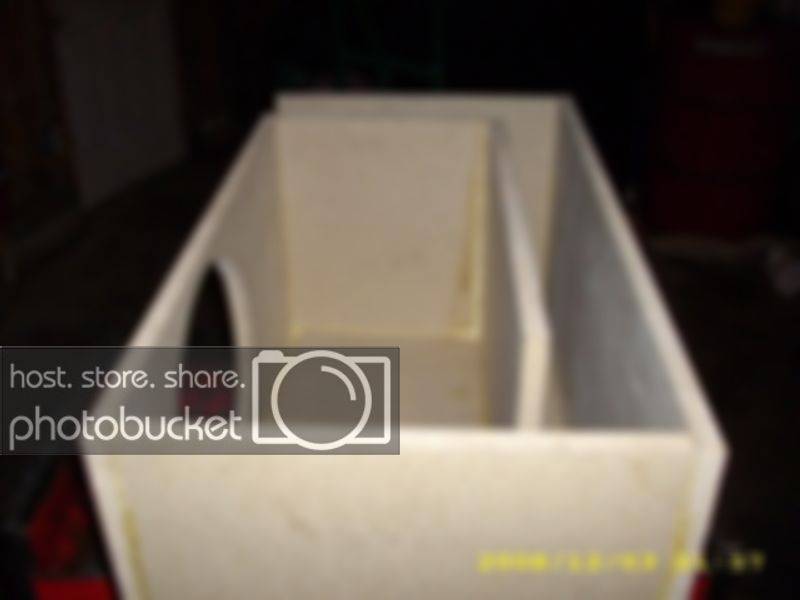

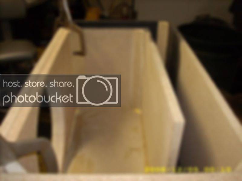

I did the box draw up on RE's enclosure calculator, i know there is some argument to its accuracy but i figured its a RE sub thier enclosure calculator is good enough. Besides my tune being a little off isnt a huge worry to me, it still works. This is the first finished product minus the top.

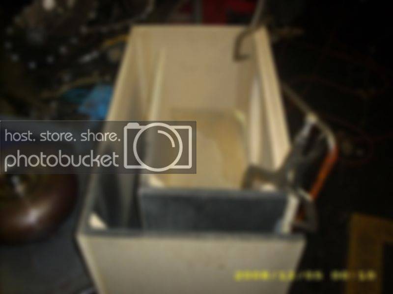

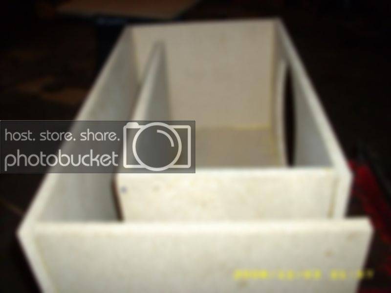

I didnt like how thin the edges at the top and bottom of the speaker hole were and then i read the thread on here about someones baffle breaking into pieces and going through their cone so i ripped it back apart and did some modification. This was my next finished product minus the top.
I feel a lot better with the 1 1/2 baffle on it, the corner braces were kind of "just because" i don't even really know their intended purpose all i know is they take up more of my internal volume and mess up my tuning frequency even worse. So with out the double baffle and the corner braces the box was supposed to be 2.0 tuned to 32hz. Final numbers on it are a mystery.

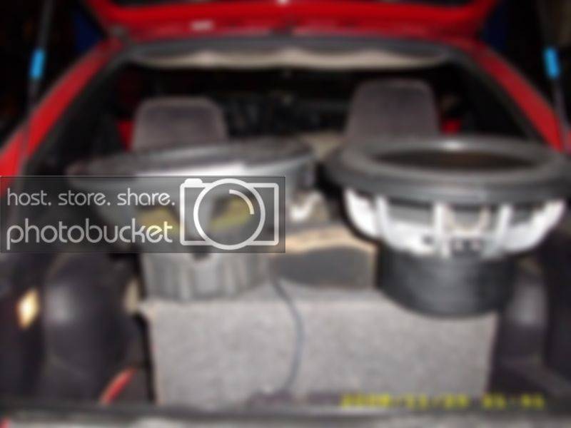

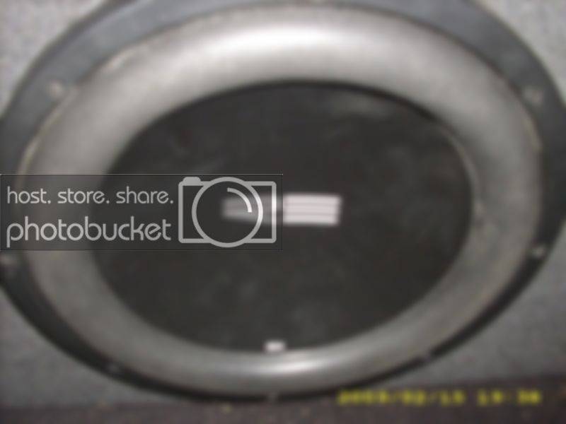

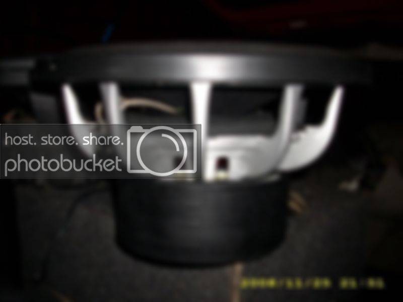

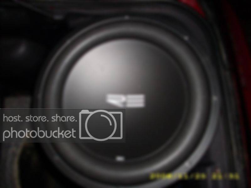

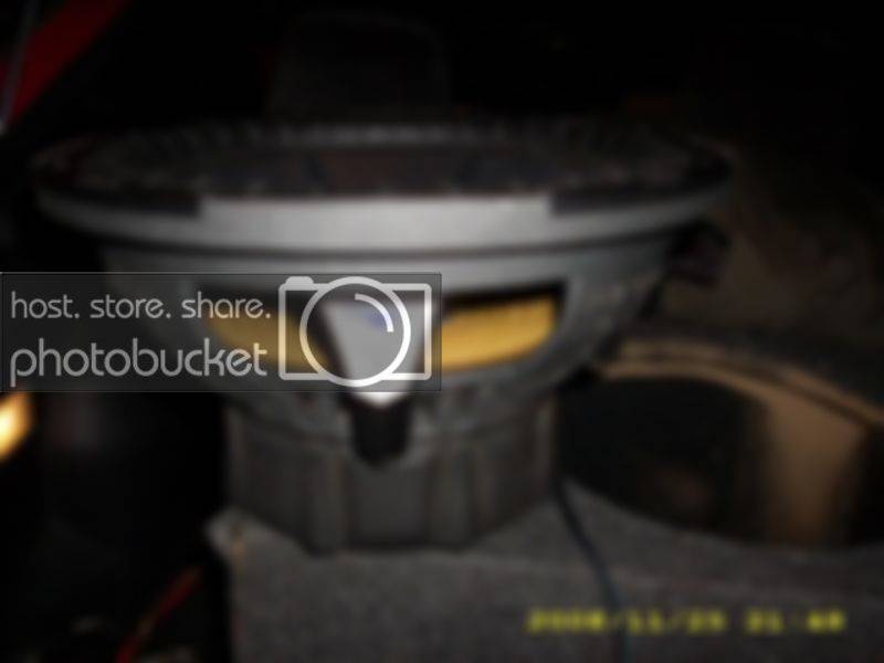

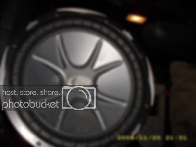

Heres the sub pics. This is the damaged CVX with my fresh out the box RE SX
This is the RE in the box that ended up being like .80 tuned to 55hz. Now that i look back at it with my current knowledge i feel like a 'tard for thinking that box was even remotely adaquate.

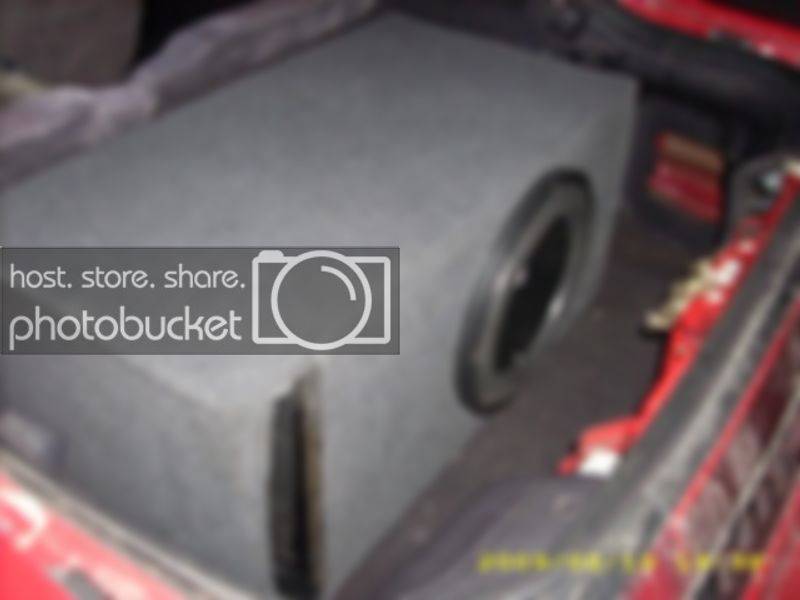

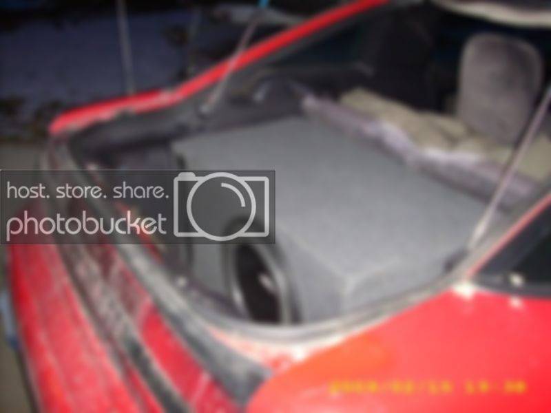

this is the finished product, with its crappy $4 fleece wrapping. I know it looks like shit, but its better than bare MDF.

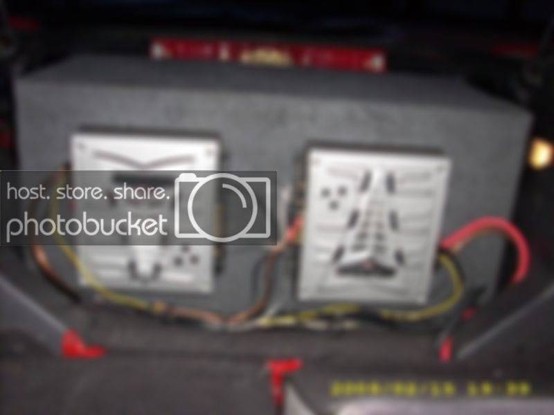

The strapped baby kx 400.1's. Supposedly it should be close to 930 wrms but who knows whether the kicker birth certificates are BS or not. And it drops to 11.8 volts or less depending if i have the heater or headlights on so who knows how much power it is actually getting.
As far as charging system, i have big 3 in 4 ga. on stock everything including the stock 65 amp alternator. Im looking into swapping to a 90 amp saturn alt. soon and if i ever get it metered im just going to throw a spare regular batt. in the hatch for the day and run a cable to the amps.

looks good for your first build man.... good job. just remember, if you aren't happy with the way it turned out as far as the size and tuning, just build another one. that is the way everyone learns and the only way to get better.... keep it up and good job....
oh yea... how does it sound???

wouldnt the baffle not effect the area in the box? how did it go from 2.0 to .8 with just the angles and the sub?

Just so you know, thats not MDF, its particle board. MDF is a light to medium brown board, hard as a rock, more of a compressed milled paper product than wood. Particle board will also soak up water like a wick and blow up (swell). I have had pieces in my parking lot swell up to twice its original thickness. MDF will **** up a little moisture but nothing to be concerned about. You already noticed the other problem with particle board, it warps. Its not nearly as stable as MDF.
If you do make another box later on make sure to get some MDF.
Yes the baffle would affect the area of the box how he has it if I understand this correctly, it will cut down on the displacement of the sub and therefore add a little space in the box because it isn't flush mounted so the sub doesn't "stick out" as far into the box. As for the box going from 2.0 to .8 I believe he was referring to his first box being .8
