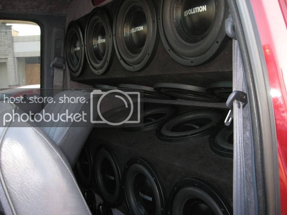

Old setup 16 10" sonance subs on 8 RD 3250's at 2 ohm's. This setup would maintain a 158 average on music when I dropped the ohm load just too much on the subs and they would bite the dust after a long run.
So my new goal is a 160 and the new setup 16 10" alpha's larger coil more spiders on subs and same 3250's at .5 ohm. 2 4 X 100 rd amps and 8 6.5 RD coax. Carbon fiber box and door panels, more lift, thinking about 30 batts this time, and a new paint job lambo orange. Mayfield's Performance is doing the paint and from what I have seen they do some great work. I will also be adding firestone airbags to handle the additional weight.

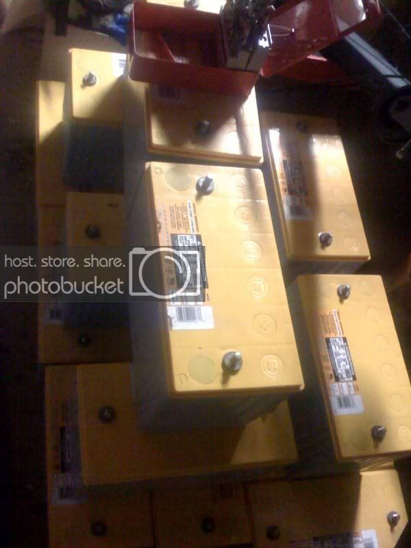

19 batts

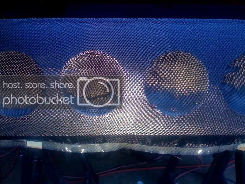

Carbon fiber with wet out coat

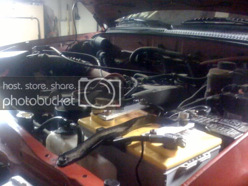

New battery under hood

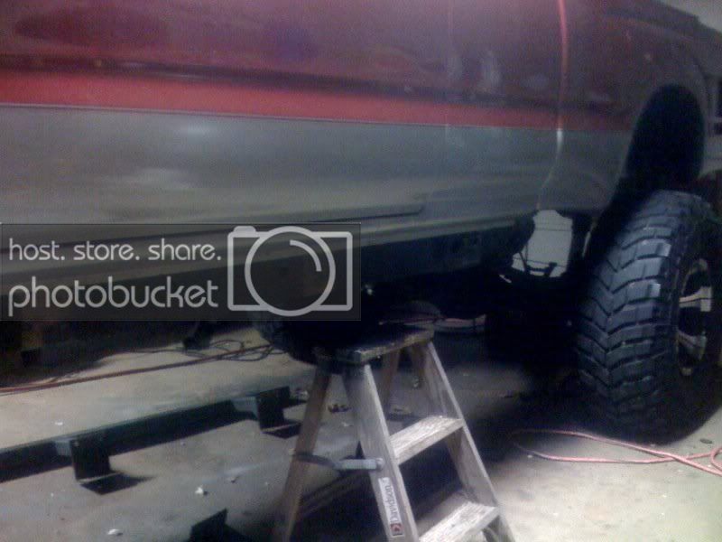

That is a 2 foot ladder under the truck

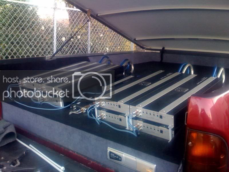

Same amps just will be spaced across the bed instead of stacked
Old setup was sealed? Or is that a port at the top?Baffles me how you have the airspace for that many drivers, how many cubes will the box be. And why carbon fiber?
Sealed setup. Carbon fiber for looks strength, weight savings and gain of airspace. Each sub will have about .6 per after displacement.

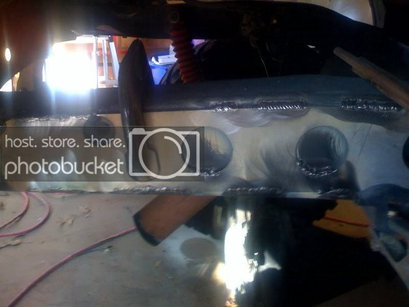

Tacoma's have a week spot on the frame they are a box frame till you get to the bed then it turns to c channel welded some metal in to fix that
