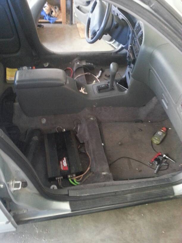

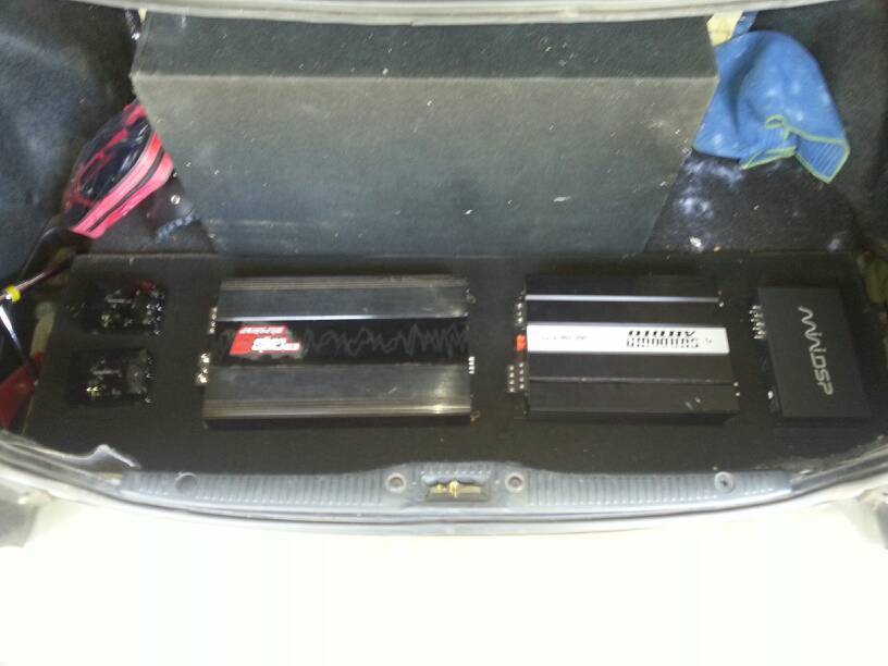

So honestly. Most my build was done months ago but because I plan on running a third amp and I didnt want rcas and wires running all over the dang car, im moving my amps to the back and ill build a small shelf or move the amps 90 degrees to fit a 3rd when the time comes.

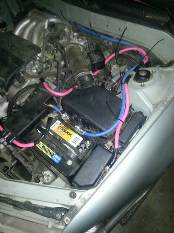

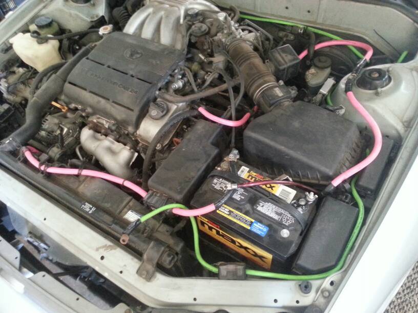

tearing everything apart. Gotta undo all the nice wiring from the hood.

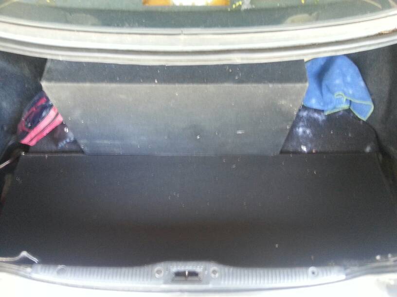

Half in mdf wrapped in carpet.

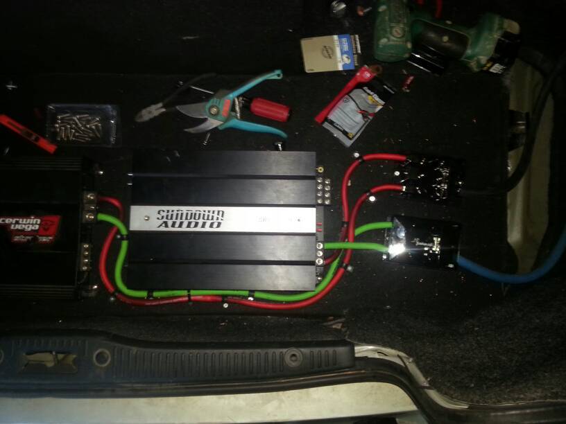

I want my power coming from the left and unfortunately that means my amp logos will be the wrong direction. Oh well.

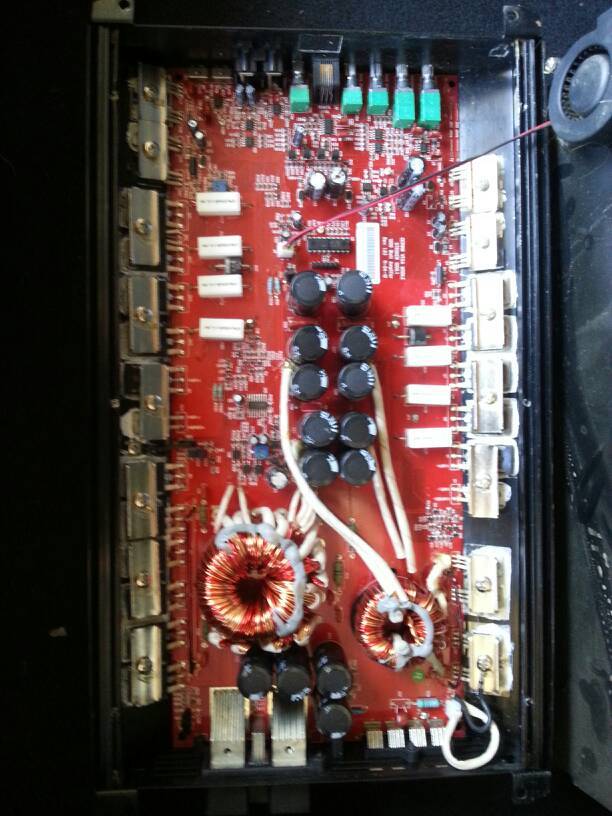

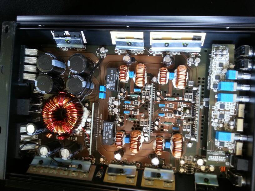

Amp guts of Sundown sax 150.4 amd Cerwin Vega Stroker 1000.1
I like to see the wire and i plan on putting a beauty panel over the whole thing anyway.
Didnt pay for my neon wire just to hide it :3

I had the foot mat half covering the amps. The sundown amp has never even gotten luke warm on me. The thing is a brick of a heatsink. The cerwin vega gets hot as **** no matter what. It has a built in, albeit small fan and its a GH amp which I guess is a hybrid between A/B and D.
Ive realized I need to take care of both amps. Neither are made anymore and imo, both are speciality in a way.
If you can raise those amps up off the flat surface they will get some air under them and stay a bit cooler..Running a cross fan blowing underneath does wonders.I use Stinger 105 CFM fans,and theyre 8" cross flow/surface mounts.Ive done all my amps that way/raised and fan cooled one way or another,and have lasted for years

I wanted to build a false floor and flush mount everything. Make it all look nice but I simply dont have the tools to do it all. My next investment is gonna be a HO Alternator. Then the sky is the limit(ish) on getting loud. Still its an old car, with paint falling off and I'm just getting more and more iffy on sinking funds into the non transferable(to another car) side of it all.
