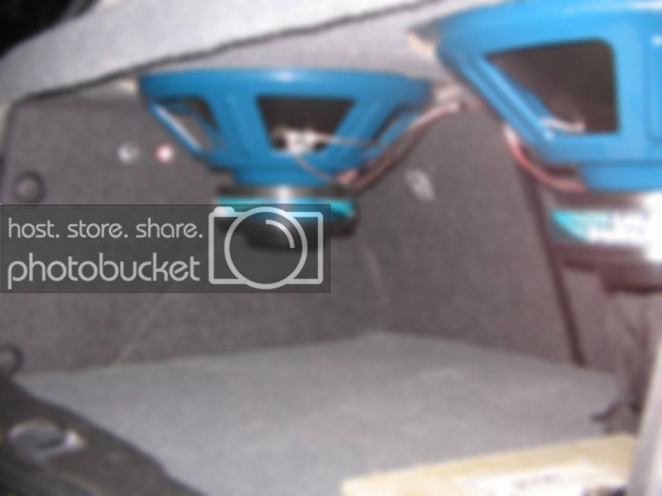

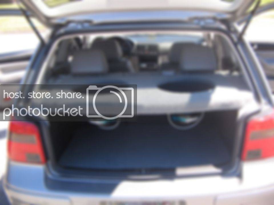

if they are free air, u dont need a ported box. it might be hard to do it in a ***** am. but u need to separate the front from the back and thats it.
see how the front is separated from the back of the subs? thats what u would need to do if they are Free air, or infinite baffle subs
the closest thing to a serial number would be F12a you can google that and get the right subs :/ the rear t-top well would work perfectly for the subs in this scenario! im hoping to upgrade to some much larger 12's sometime in the next year, so at that point i'll have to build a real box...
