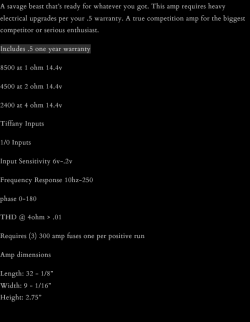

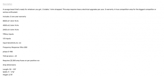

Ruthless is selling at a few places now because of the popularity of them and tbh can't argue with that. They are a tank come with a 0.5 ohm warranty for one year as well. Rare to see that these days.
Instead of wiring an amplifier up below recommended ( and buying a more expensive amplifier to be able get away with wiring it too low ), why not just go full bridge and buy the next size up? A Soundigital 12k is about $1000. Even with impedance rise you will still be 8k.
.... that you can buy for an extra 200$ .... if they were even in stock.
Has that company even been around for one year? Why would you even want to run into .5 ohm?
Actually no it includes that 0.5 ohm warranty from SSA and Ruthless. Those amplifiers are the same ones from Korea that others make as well. If the price wasn't so high I would done the 4500.1 for my last purchase but went with the Cab-45 instead because I got it at a good price. Even if it needs repair after the 1 year those are fixable at most amp repair places that do them.

Eh no biggie hispls. Yeah for some of those companies they want that extra 200 bucks for that 0.5 ohm warranty. I wouldn't pay it either,lol. One nice thing about my bank and what not they add a 2 year warranty onto any item I buy so even if I ever had an issue with something like that I send it into the place of my choice and they eat the bill on it. Kinda nice and used it once on a tv that was out of OEM warranty but 1 year into that extra and they just paid for a new tv instead.
I'm more and more leaning away from not messing about with .5 whatsoever. I'm with Dragon Breath on the whole instead of buying a 8K@1 ohm amp from a brand that may not outlast your current pair of work boots and run it down to unsafe impedance for 1300$ when you could own Chinese Soundigital 13K knockoffs (or the Soundigital for a little more) and it'll make 8K into 2 ohm.
There's almost no competition orgs/classes left that give an edge to "cheater" amps, .5 is just really bad for semiconductors, and while I'm not a big "damping factor" cultist, at .5 ohm you're dancing around the area where it may become audible.
