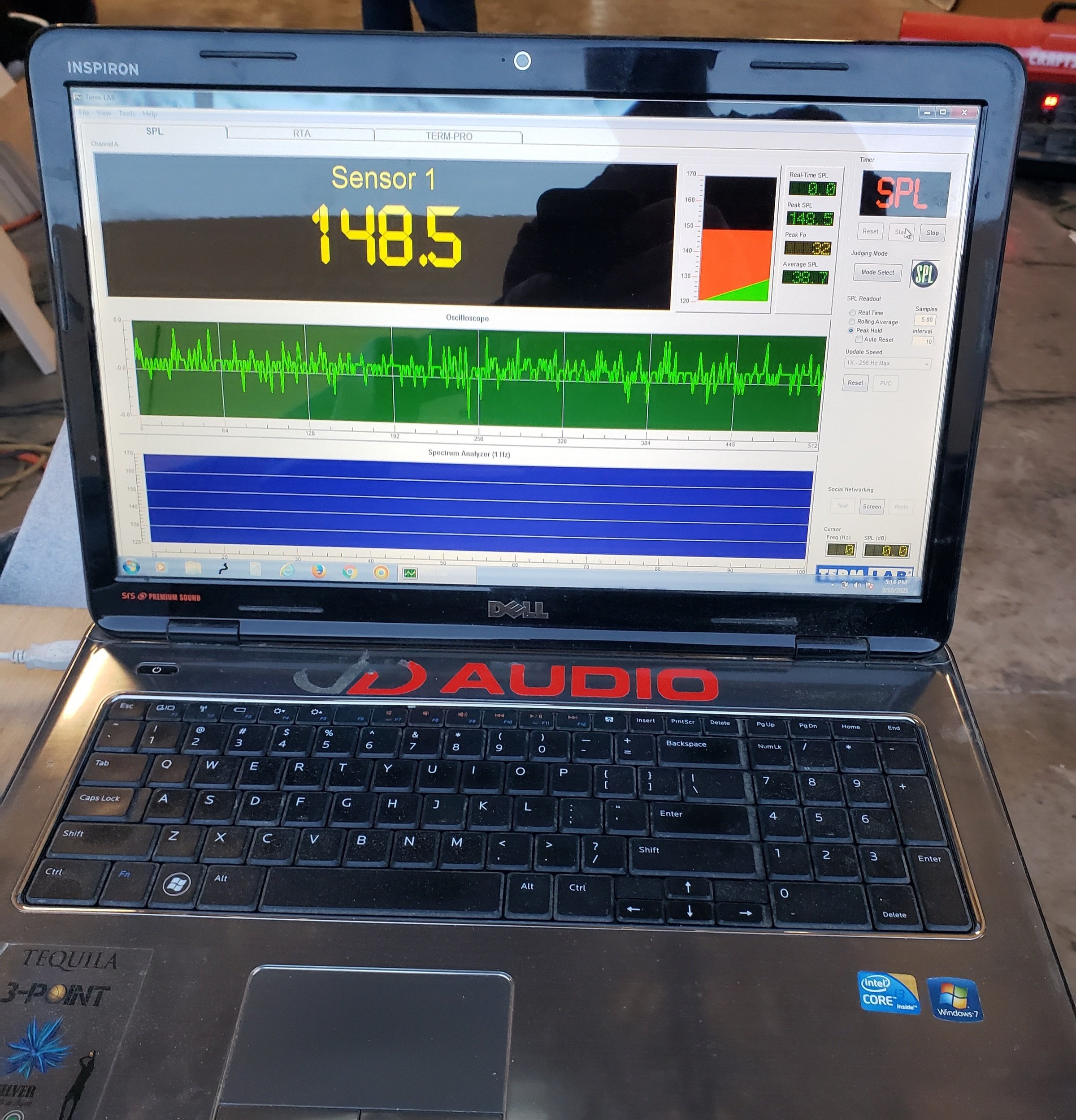

I've got 4- 8's in 4.1 cubes net and pushing them with a 3K amp and it gets low. It did a 148.5 at 32 hz. from the kick. I think the bigger box will help them dig lower.

Well, I'm not sure if the 4-8's could take 4K. They are 600 rms each. When I demo them, my installer always tells the people, "he has them in a big *** box and tuned low (33hz.)" He's the expert and always comments that the size of the box helps them dig low. The lowpeak is 29hz. and the high peak is 40 hz. I'm in a single cab which is an advantage, but he said that I will piss people off when they see that meter for 4-8's. I'm sure that when I switch to lithium it will touch 150. I'm thinking .75 per sub and 4K might be as loud but not hit as low. Maybe, 146's at 38hz. if I had to guess. All things being equal.
