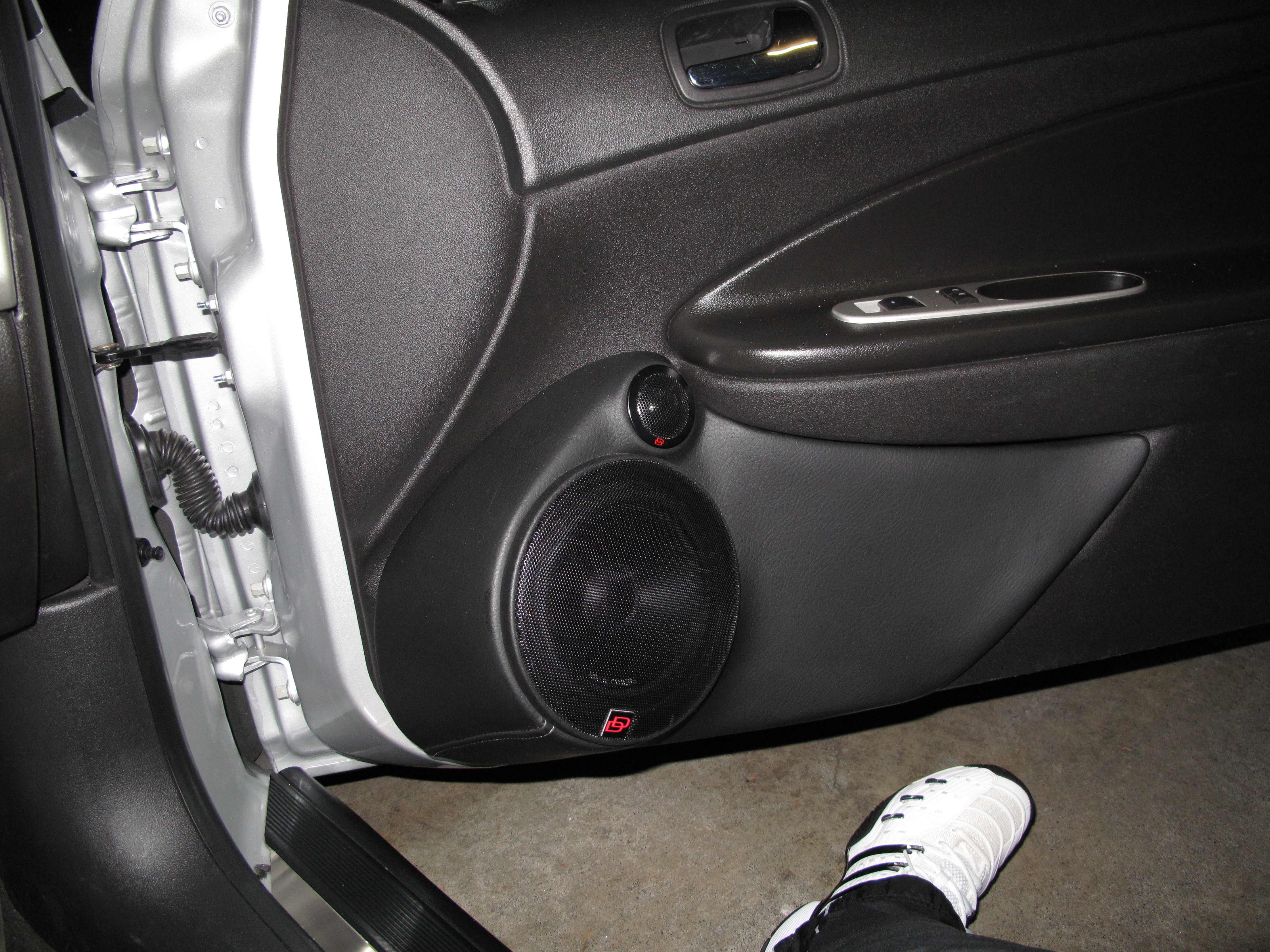

These were the 6.5's I had in my last car
They were great for mid bass
