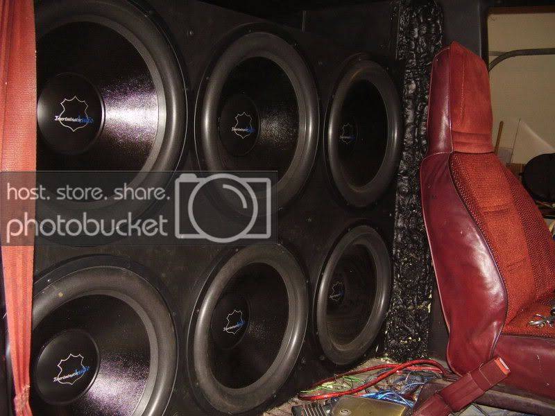

6 18" IA DR's
S.B.C.

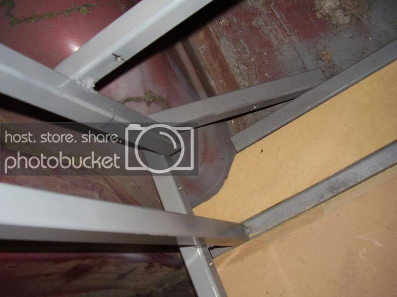

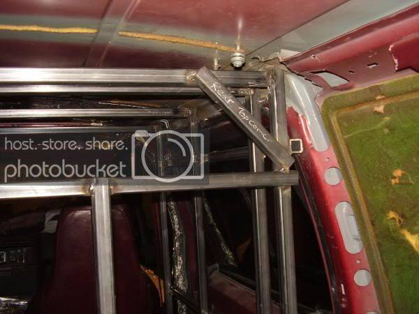

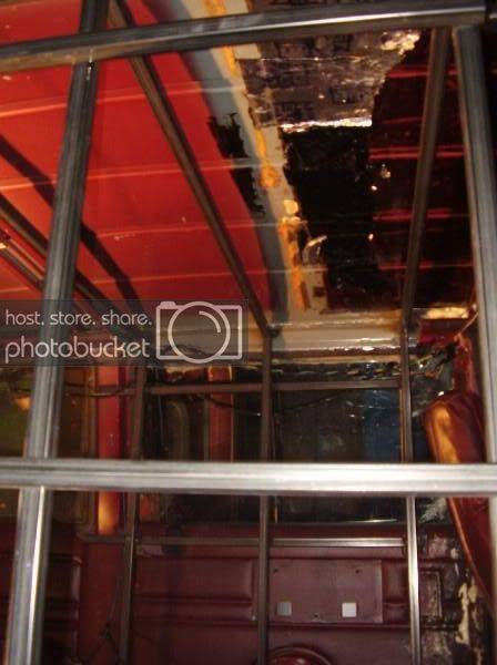

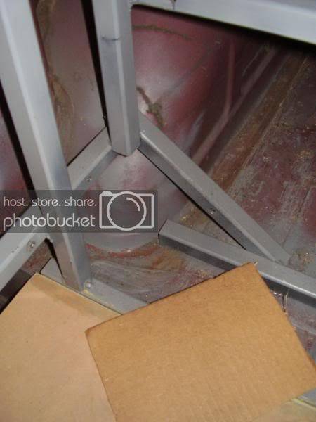

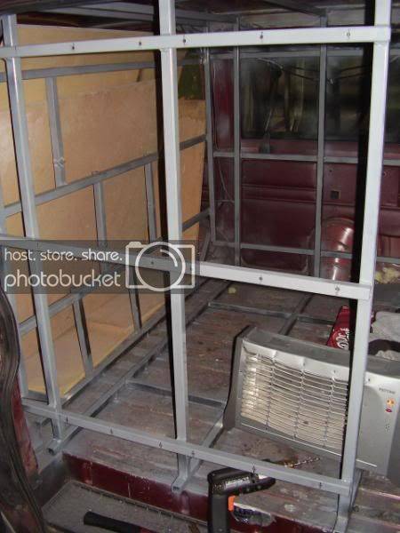

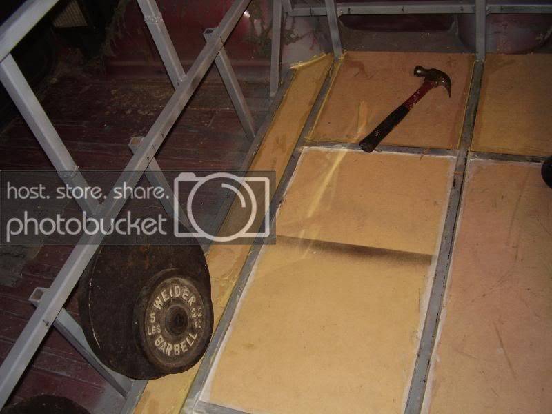

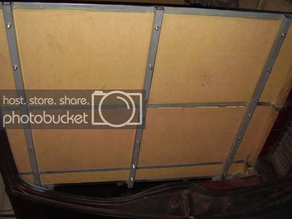

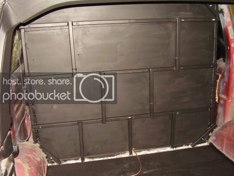

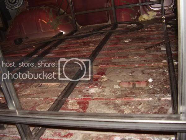

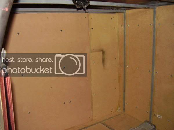

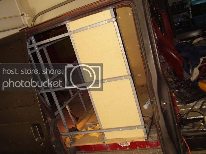

1x1 steel cage welded in- all mdf bolted to it

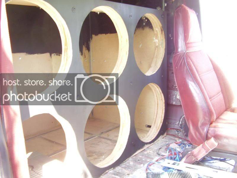

I've yet to see 3 18s across- and stacked 2 tall in a vehicle yet, so I thought it'd be a change..
6 18's- 7K- 3 Batcap 3000s- 2 alts..

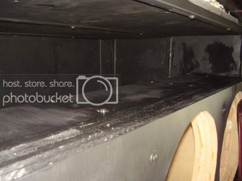

36cu ft. internal after sub n port displacement. 460sq in of port- tuned to 34hz.
No #'s yet- will post em when I get em

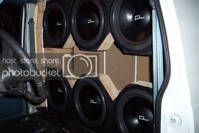

looks good,this was my 6-18's
Heck ya- i knew it had to be out there somewhere!

****. wanna see #s... nice work, quad baffle?

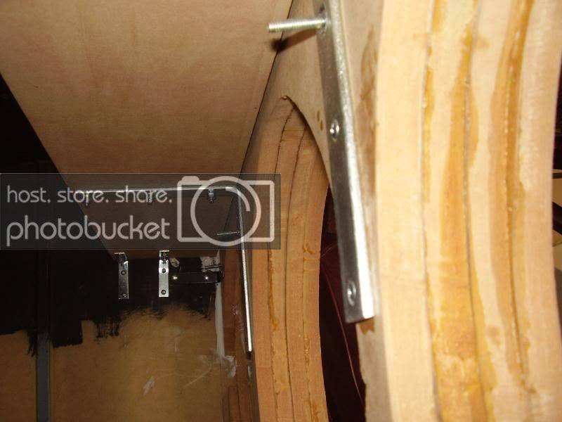

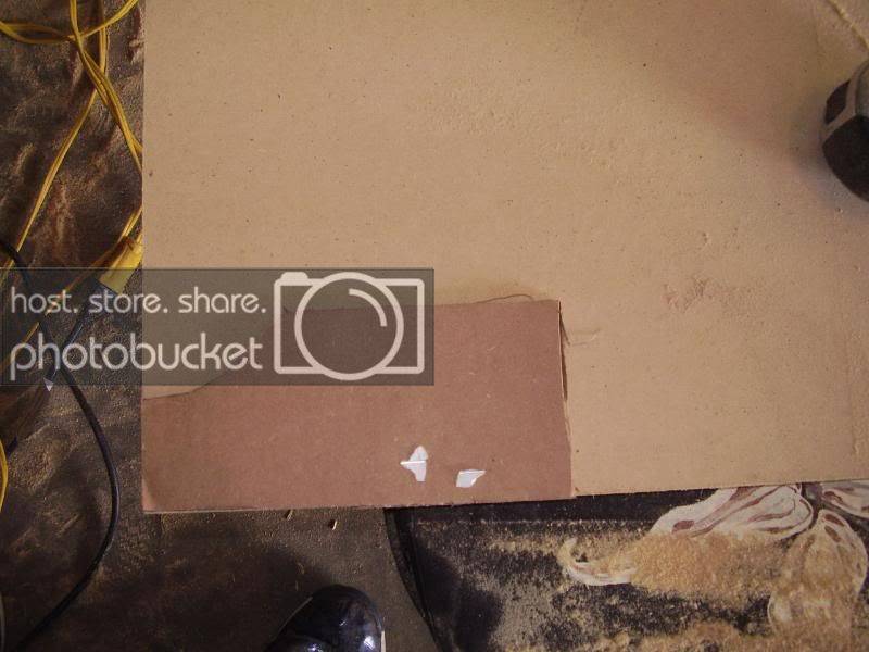

Yea, 4 3/4 baffles bolted together.
over 20 3 to 4in L brackets.
Should be bomb proof //content.invisioncic.com/y282845/emoticons/laugh.gif.48439b2acf2cfca21620f01e7f77d1e4.gif

Its nice to see someone doing a wall the right way. I hate seeing all these wall builds with no support holding them in. Nice work! //content.invisioncic.com/y282845/emoticons/wink.gif.608e3ea05f1a9f98611af0861652f8fb.gif
